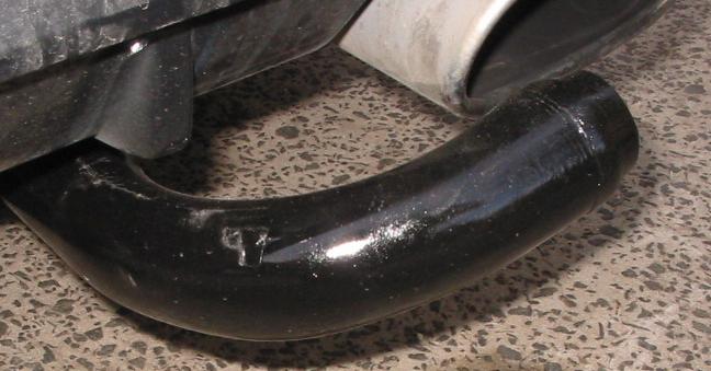

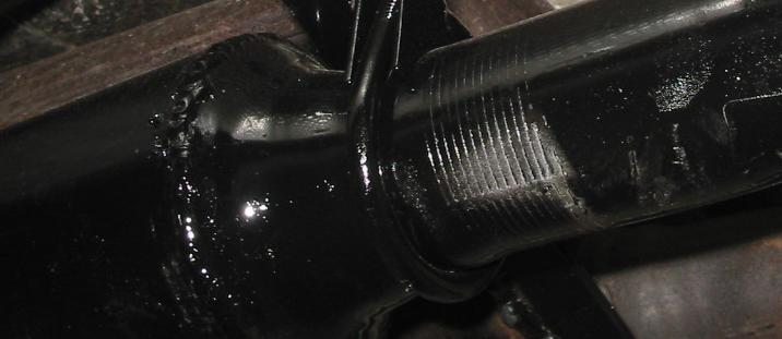

newxr Member 279 Member For: 22y 5m 26d Posted 12/05/05 04:50 AM Posted 12/05/05 04:50 AM Hi AllA few weeks ago I suggested a Venturii Exhaust Assist device - essentially an air sccop under the car that passes air through a narrow tube to increase its speed and then the fast airflow is directed behind the tail pipe to reduce the pressure behind the tail pipe to assist exhaust evacuation.Well I built and mounted one and tested it using my G-TECH3 Runs without the device - mean 138.6kw (best run = 139.4kw)2 Runs with device - mean 144.5kw (both runs over 143kw) All runs within 1 hour of each other on the same track
Mercurial Member 47 Member For: 23y 5m 14d Posted 12/05/05 05:11 AM Posted 12/05/05 05:11 AM Looks like it works mate. Congratulations.Would this basically have the same effect as putting a larger exhaust on? (And therefore be potentially a cheaper alternative for the same performance gains??)
Paradoxx Colossal Member Member 5,049 Member For: 22y 1m 17d Gender: Male Location: Perth, WA Posted 12/05/05 06:02 AM Posted 12/05/05 06:02 AM (edited) So it basically creates an area of low air pressure directly behind the tailpipe and hence causing the high pressure air in the exhaust (hot air) to escape more quickly lowering the high speed back pressure created by the exhast... is that how it's working?Very interesting concept... Edited 12/05/05 06:04 AM by XXXR6T
newxr Member 279 Member For: 22y 5m 26d Posted 12/05/05 06:11 AM Author Posted 12/05/05 06:11 AM So it basically creates an area of low air pressure directly behind the tailpipe and hence causing the high pressure air in the exhaust (hot air) to escape more quickly lowering the high speed back pressure created by the exhast... is that how it's working?Very interesting concept...<{POST_SNAPBACK}>The exhaust is normally of lower pressure than the atmosphere however it can escape due to its speed however by lowering the resistance behind the tail pipe this just helps it along. My set up has a 3.5" intake with a 1.5" exit so at 60km/h the air is exiting the device at over 240km/h and significantly reducing the presuure behind the tailpipe. Older F1 cars had the exhaust pointing down as the air rushing below the car reduced the pressure and the exhaust flow was improved.

eMPee Member 247 Member For: 22y 7m 3d Location: Sydney Posted 12/05/05 07:06 AM Posted 12/05/05 07:06 AM So why dont cars now have their exhaust's pointing downwards?Can it work from the tail pipe that was bent down that wasin fashion a few years back work?interesting.......
Paradoxx Colossal Member Member 5,049 Member For: 22y 1m 17d Gender: Male Location: Perth, WA Posted 12/05/05 08:39 AM Posted 12/05/05 08:39 AM Ahhh I seeI can't imagine it would make any difference to your ET since the car isnt moving and therefore no flowing air.
Trough Lolly Member 4,349 Member For: 22y 1m 3d Gender: Male Location: Mildura Posted 12/05/05 08:47 AM Posted 12/05/05 08:47 AM so the VL Turbo boys were on the right track with downwards dump-pipes? lol...
