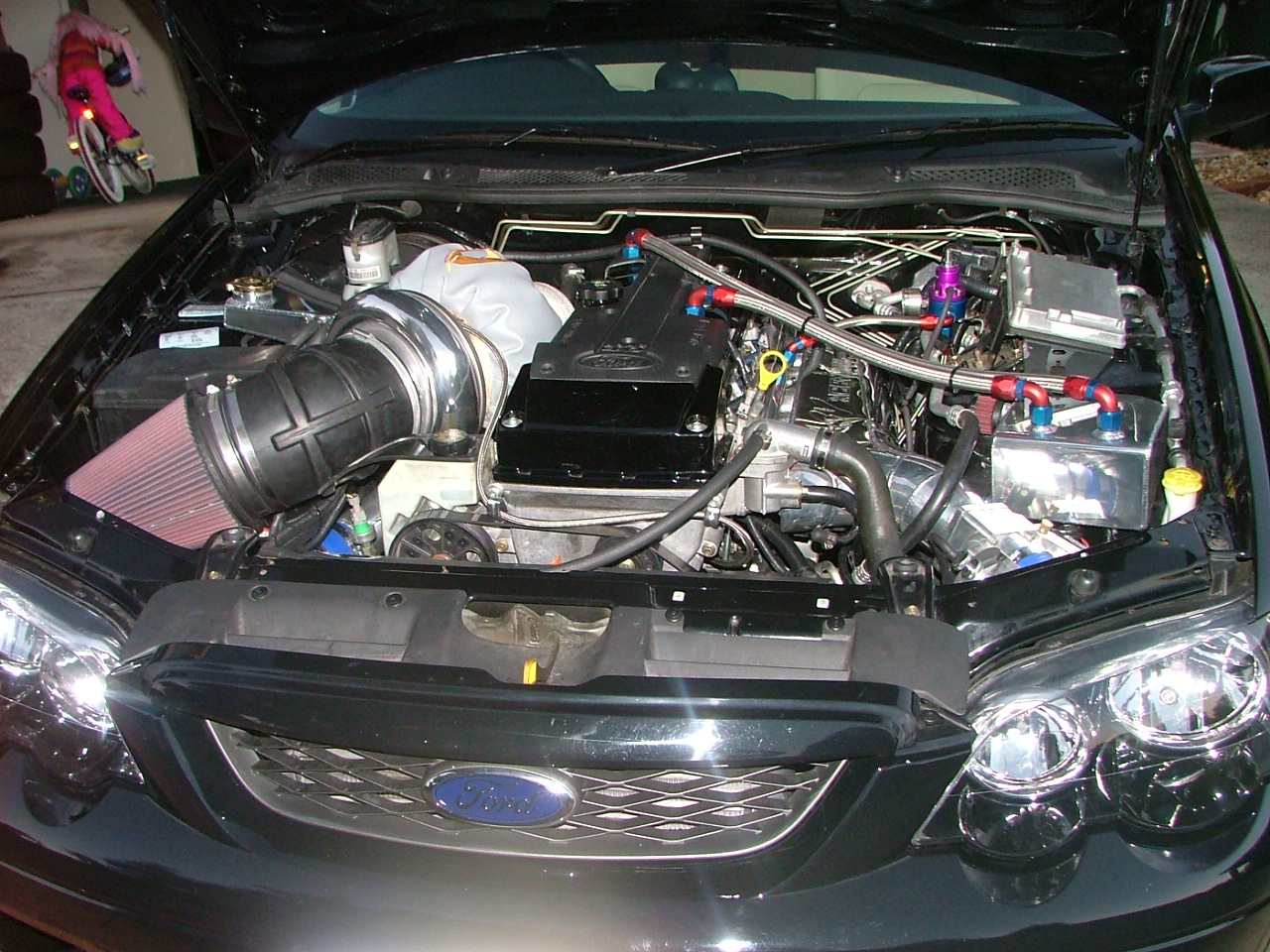

SPIKO Legacy Donating Member 1,924 Member For: 21y 5m 10d Gender: Male Posted 04/05/05 10:10 AM Posted 04/05/05 10:10 AM Hi all thought you may like an update on my project.Well today the car recieved injectors 880cc wich Mark from Injection Perfection atBankstown was kind enough to donate THANKS MARK they run perfect.Run it up on the Dyno @ 17.5psi made 620rwhp @ 6800rpm and stayed there till limit that was set at 7200rpm.Ignition system didn't want to know about it even at that tune as it is standard but with a few smart mods by C&V it started responding as it should.Tried to give it another couple of pounds of boost and valve springs gave up also, mind you they are not standard but still could not handle the thump this turbo produces it's scary!!So new ignition is being sourced and valve springs custom made to cope with the CFM that the snail provides and we will be at it again.Everything above is achieved with BP Ultimate 98ron fuel, full exhausts running 2 cats and no NOS, and an Edit tuned by C&V no fancy CPU's AS YET!7200rpm on Edit with pump fuel and no billet crank pretty impressive I think so far.Big Well DONE to the boy's from C&V.I have a half car system exhaust that is not on the car as yet!Ignition system still to come!C16 fuel still to come!And NOS not on the car as yet.But definatly will be fitted!One thing I will say is Yarrra valley Auto holding up very well so far.AND MOST IMPORTANTLY MODIFICATIONS DONE ON REAR END AND SUSPENSION ARE BEYOND BELIEFE TRACTION WISE, EVEN ON STICKY 20INCH STREET TYRE'S!!!!!People that have taken a ride in the car thus far and felt the traction achieved at this HP level have exited the vehical looking like this Hope this answers some of your questions so far, sorry I haven't posted sooner but I am trying to get this thing together.RegardsSpiko

Flukey Seriously Flukey Member Legacy Donating Member 4,354 Member For: 22y 5m 27d Gender: Male Location: Melbourne Posted 04/05/05 10:16 AM Posted 04/05/05 10:16 AM Run it up on the Dyno @ 17.5psi made 620rwhp @ 6800rpm and stayed there till limit that was set at 7200rpm.Mmm, 460rwkw's, handy numbers Spiko. I take it your not happy yet?

SPIKO Legacy Donating Member 1,924 Member For: 21y 5m 10d Gender: Male Posted 04/05/05 10:21 AM Author Posted 04/05/05 10:21 AM Run it up on the Dyno @ 17.5psi made 620rwhp @ 6800rpm and stayed there till limit that was set at 7200rpm.<{POST_SNAPBACK}>Mmm, 460rwkw's, handy numbers Spiko. I take it your not happy yet? <{POST_SNAPBACK}> No wear near happy yet!But not because of numbers that is not what I have built the car for (Dyno Runs etc.)Ill be happy when it runs the quarter mile times and only then!Not far from this happenning now.I do not want a 10That I now it will achieve as is!!!!!!!!!!I want a 9.So I must wate.
