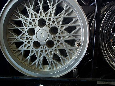

XR6Turbo22 Member 86 Member For: 19y 1m 6d Gender: Male Location: Melbourne Posted 11/10/07 04:00 AM Posted 11/10/07 04:00 AM you might be able to, you'll just have to see if you can get a wheel with the right stud pattern, as all the BA's have 16" minimum, maybe an AU, but I think the offset is different...Would the old school EA-EB "snowflake" style 15" wheels fit?
senna_T Forged Member Legacy Donating Member 15,818 Member For: 19y 7m 21d Gender: Male Location: SW Sydney Posted 11/10/07 04:03 AM Posted 11/10/07 04:03 AM I'm about 99% sure they will not fit, EL was a different offset to the ba, so EA/EB will be different, you could call a tyre shop like bob jane or something...
Fry Member 123 Member For: 19y 3m 6d Gender: Male Location: S/E Melb Posted 11/10/07 06:03 AM Posted 11/10/07 06:03 AM they will fit but will look like sh*t cause of different offset they will stick out a little further on the side of the car past the guard
XR06T Legacy Donating Member 4,146 Member For: 21y 3m 5d Gender: Male Posted 11/10/07 06:08 AM Posted 11/10/07 06:08 AM (edited) you sure those rims are going to fit over the brakes? there is mm room with my 16" au fairmont rims and stock brakes.in typing this but I do recall the gtech car using that style rim at the track...... Edited 11/10/07 06:09 AM by XR06T
