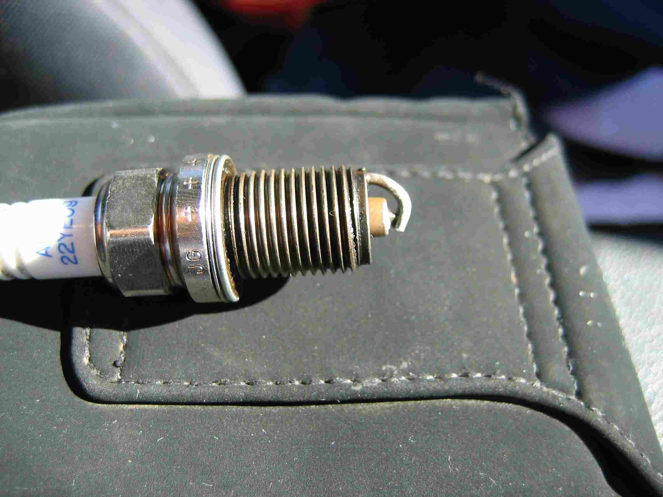

  14. My mate has all ready told me that he wants the rod so he can mount it and hang it on my office wall . Guess I am never going to live this down . It happen just as I was slowing down to turn right at some traffic light doing about 20 km/h, car ran rough like it was running on 5 pots not 6. So I drove the last 1 km to my mates house, wait for the motor to cool and pulled out the plugs and that's it. Running about 14 -15psi and has all the mods listed in my sig. Its a chance we all take when we mod our engine's and I new this when I started doing the mods. Its going to cost me $$$ but at the end of the day I will have a stronger motor which I know will give me plenty of power and I dont have live under the cloud of "will I bend or throw a rod" like all the other guys with good power and a stock bottom end
  15. The photo tells a thousand words or should I said a bucket load of $$$$ . Its my spark plug out the number 6 pot which I am guess has a bent rod as I have had the rocket cover off and the top end looks good, but can not be 100% sure until the head come's off. So looks like I will be saving up for a full rebuild and having my car off the road for a while. Good job its not my daily drive. This begs the question can I claim to be the first person with a BF to bend a rod
