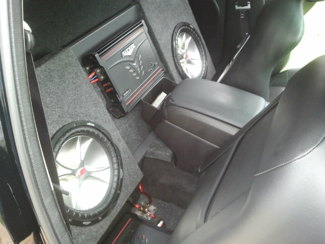

  9. Obviously the base is on the ledge and heaps of velcro. It's planted firm and not going to move at all
  10. As far as the volume for the sub enclosures the volume is not far off. I used the kicker website Sub box dimension for a single sub and matched that. Obviously my enclosure isn't flat on the top however it is higher than the kicker product to try match the same volume.
  11. Yeah the base of the box is raised off the ledge by about an inch.. just to allow access to the jack on the passenger side, I've placed MDF on the bottom of the box on either side of the box (like wings which go to the edge of the cab (covered in carpet)) to stop lateral movement and the base with heaps of velcro. Yeah I know if I roll the car I might end up wearing a 12" sub on my head touch wood but I done what ever I could to not drill holes in the car. I tested it and done hard braking and thrown the ute through a few corners just to test that it's not moving and it's not budged one bit!!

  15. Hey Tom, All the stereo gear I had sitting in the spare room for approx 6 months and mate it was bugging the sh*t out of me that I couldn't find the time to put it into the car. Really all I required was the sub enclosure materials and the Sound Field Processor to complete the job. Soon as I found the Bit Ten going cheap I swooped!! Found the materials for the subwoofer enclosure so conveniently sitting in a shipping container at work (inside insulation and the thick marble finish MDF) I swooped on that too. Basically worked 2 long weekends (morning start through to midnight). Relatively cheap job however I did what I could to make sure it was done properly.
  16. Might be able to fit an amp under the passenger side seat but drivers side might be tight due to the seat mechanism. The sound processor is in the cab behind the drivers seat on the side of the sub enclosure. As far as the sound resonance through the vehicle... I have had it cranked and the panels are as tight as!!! Don't know how it will hold up in 5 to 10 years time but it will be long gone by then.

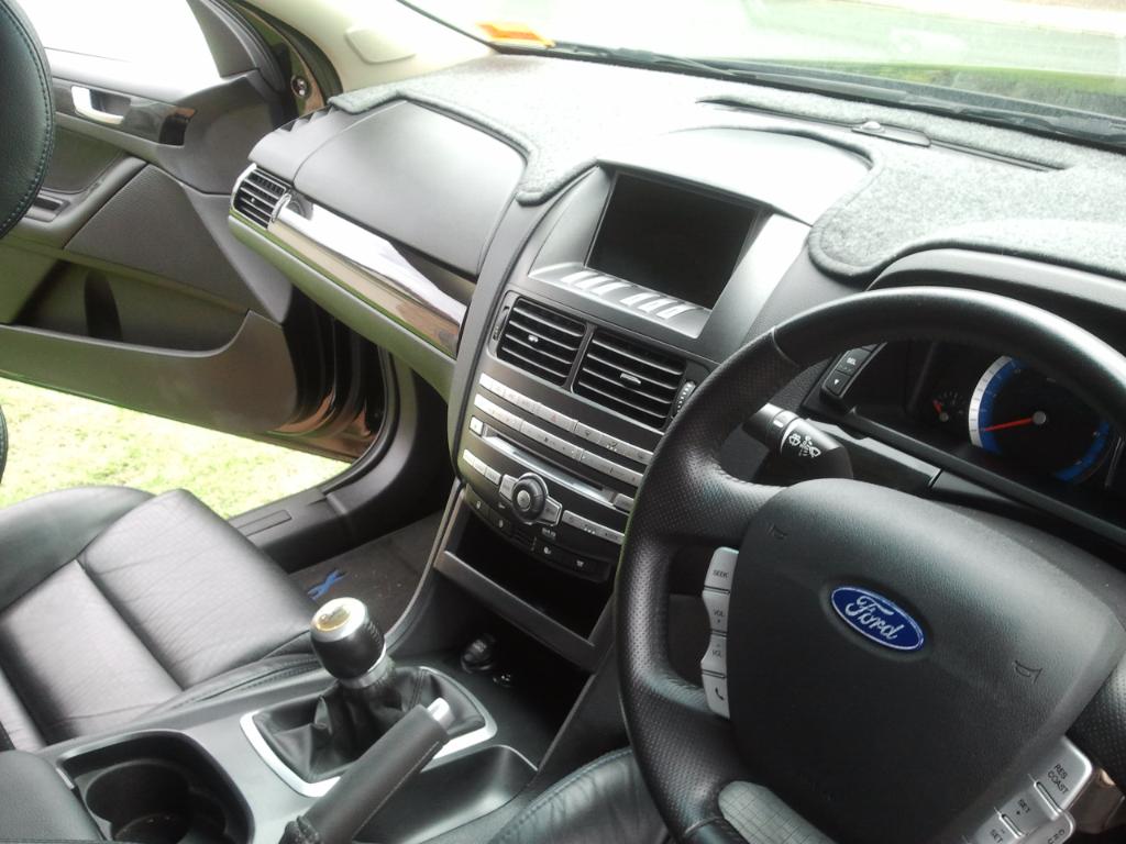

  17. Well I finally finished the install of my system into the ute....and absolutely blown away.. I went with the Audison Bit Ten processor and yeah they make a good product. I have a little bit of noise when the head unit is set at zero but once it's up...mind blowing crystal clear sound!!! I considered getting it installed by a shop but after quotes in the $1800 vicinity I ended up doing whole system myself Basically done my research, planned the build (routing of wires etc), I manufactured a custom sub Enclosure to house the 2 12"s behind the seats/ Amplifiers in the cab of the ute and installed the processor etc. The sound stage in the ute is mind blowing (and that's with the 'out of the box firmware' operating the system...haven't got around to updating the software on it with the laptop yet!!). The install turned out beautiful....pain in the a*s at times but the end result was worth every bit. No cut corners, no body mods or drilling required at all to the car, looks completely stealthy in every way (umm until you see the amplifiers and 2 subs aimed at your seats!!! and the sound quality is like driving around in a sound studio!! The two 12's hitting the seats is simply lethal with zero distortion, a snare sounds like a snare, guitar sounds like a guitar...I can't help but now drive the long way home!!! hahaha I've since pulled up alongside other FG and SS utes and they spinout that the Bass is coming from an FG!! Heres some pics!!

  22. Yeah I put 6.5" Focal Splits in the doors. I ordered mine with premium sound so has the tweeter possie's in the A pillar. Had to rip out the factory 6.5 speakers in the doors (there is a few threads about taking the door trims off). It's a piece of cake. I made spacers out of mdf so that the magnets for the focals (fairly deep speakers) cleared the windows..30mins tops! The rears are 6.5" speakers as well and are so basic it's not funny no modification whatsoever (placed Focal coaxials in there). I have just finished the install and made a custom sub box with 2 Kicker 12" comp Subs, 1 x 750.1 Kicker Amplifier powering both the subs, 1 x 400.4 Kicker Amplifier powering each of the speakers all run off a Audison Bit Ten Sound Field Processor so I can still use the Factory OEM colour screen...Ipod integration, steering controls, bluetooth etc. Some people have complained about the Factory Head Unit being quite noisy however I have found the Audison black box to be awesome.....and to say the sound is amazing is an understatement. yeah there is a little bit of noise when the stereo is on zero...but when listening to music it is crystal clear....and the bass coming from the 2 12's right behind the seats when it's cranking is lethal!! The Bit Ten allows you to plug your laptop in and you can tune the system (time alignment, crossover and filter points and equalisation).. I still haven't had a chance to plug the laptop in yet to upgrade the factory software on the box...still running the program straight out of the box and can't be more happier with the quality of the sound stage and I got quotes from stereo shops to install my system and was looking at a ball park figure around $1800...and that was to make the enclosure for the subs, purchase a sound processor (which you need if you wish to run amps). I decided to have a go at it myself and all up to install it cost $470 (purchase of the Bit Ten...normally $800 roughly, carpet and 2 bottles of Johnnie Walker. The Sub Enclosure I designed and manufactured myself from a solid Laminated MDF (just done research on porting etc) which I found at work (for Free!!) and sealed and insulated the inside of it myself I will post photos up as soon as I get a chance but any questions feel free to drop a line. My opinion...Do it!!! I'm no installer (just a dirty old Asphalter!! lol) and as everything was done in my own garage with nothing but a testing probe (for checking negative and positive wires, (Speakers), Jigsaw, cordless drill, Torx tools and a phillips screwdriver...Just takes time..but worth it. I've pulled up beside other FG and SS utes at the lights and they spinout that the sounds and bass are coming from a relatively new ute!! My only suggestion is do ya research...don't cut corners( AT ALL!!), and take pride in your work and you'll be blown away by the results!! Although mine was done cheap, I bought good gear from the get go (the system is out of my BA XT sedan), Make sure ya insulate your wires (Power cables for the amps etc), good earth is a necessity, and take the time to plan the build (routes for running cables etc), location of amps, which sound processor to use (every one has their own opinion on what brand (Alpine, Audison etc)).....don't get suckered into buying a cheap one or look forward to enjoying copious amounts of background noise!! In the end mine was a stealth install unless you look behind the seats!!!, no holes drilled or bodgy mods whatsoever and done my utmost to make it look as clean and professional as possible!! Good luck Tim
