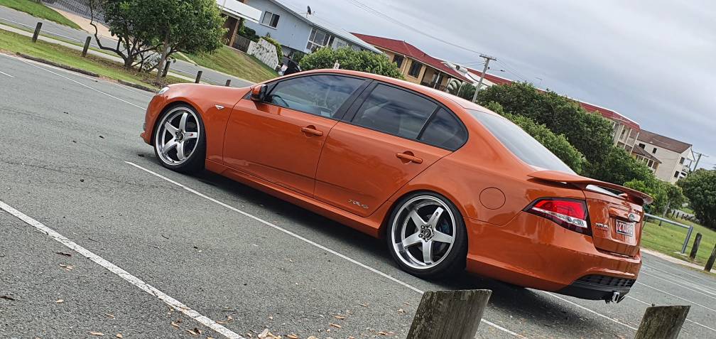

  2. These are pretty common, Lenso D1R 20x8.5 +35 and 20x10 +42. Bilstein shocks, King SSSL front and King 68SP4 rear. The rears are meant to be 10mm lower than SSSL, I changed to them to remove some forward rake due to the tyre profiles (245/30 and 275/30) but there's still some rake. There's good clearance to the guards, the rear control blades and the front spindles. Nice straight forward fit. Cheers
