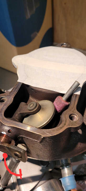

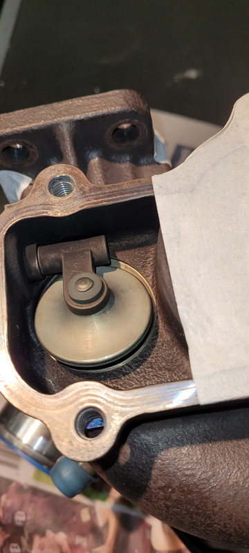

3Katz Donating Members 122 Member For: 7y 4m 28d Posted 24/08/22 11:57 AM Share Posted 24/08/22 11:57 AM I bought this turbo (Garrett GTX3582 gen2) brand new with porting and a 39 flapper already done. It's probably done about 1000k and a few dyno sessions. I bought this model as I expected the lag to be not much worse than the stock GT3582. I was surprised to find out it was quite a bit laggier but just lived with it. Due to other issues I've pulled the turbo off and found that the flapper won't fully close 9 times out of 10. It jams open enough to fit your pinky finger in. This would be the lag issue, here's a pic of it jammed open (with 0 pressure in the actuator) What's my best option from here? Is there a larger flapper I could have done? Modify the height of the flapper arm? Give the leading edge of the flapper a touch with a stone? This is a pic with some air in the actuator to open the valve a little and this is the edge I was considering giving a bit of a touch up.... (just the flapper not the seat) Better ideas? Best option? Link to comment https://www.fordxr6turbo.com/forum/topic/96781-gtx-wastegate-issue/ Share on other sites More sharing options...
JETURBO ...JD TUNING ADELAIDE... Gold Donating Members 23,708 Member For: 17y 1m 2d Gender: Male Location: Adelaide Posted 25/08/22 01:45 AM Share Posted 25/08/22 01:45 AM Setting up an actuator/bracket/angle can be tedious especially with bigger sized port & flaps so if you’ve got a flap that’s catching 9 times out of 10 it might not necessarily be the actual flap or port edge but the way the actuator arm is pushing/pulling in motion and as you can see from your top picture the arm of the flapper is right hand down, left hand up in regards to tension. This can lead to excessive flapper arm boar wear and cause “Wiggles” in the arm activation. If you play with housing rotation, bracket location, actuator can seating you can work a way for the flapper arm to be less pulled/pushed off kilter and operate on a inset outset method which conducts less angled pressure to flapper arm. Failing that and assuming the arm boar has excess wear now you might need to take a bevel edge approach to the port OD 1 Link to comment https://www.fordxr6turbo.com/forum/topic/96781-gtx-wastegate-issue/#findComment-1714009 Share on other sites More sharing options...

3Katz Donating Members 122 Member For: 7y 4m 28d Posted 25/08/22 02:39 AM Author Share Posted 25/08/22 02:39 AM 57 minutes ago, JETURBO said: Setting up an actuator/bracket/angle can be tedious especially with bigger sized port & flaps so if you’ve got a flap that’s catching 9 times out of 10 it might not necessarily be the actual flap or port edge but the way the actuator arm is pushing/pulling in motion and as you can see from your top picture the arm of the flapper is right hand down, left hand up in regards to tension. This can lead to excessive flapper arm boar wear and cause “Wiggles” in the arm activation. If you play with housing rotation, bracket location, actuator can seating you can work a way for the flapper arm to be less pulled/pushed off kilter and operate on a inset outset method which conducts less angled pressure to flapper arm. Failing that and assuming the arm boar has excess wear now you might need to take a bevel edge approach to the port OD Thanks Aaron, that makes sense. By operate on an inset/outset method do you mean to try to bring the rod to more of a 90deg angle as per the below pic, or to have no sideways tension on the rod ie disconnected from the actuator arm it should freely pretty much line up by itself. Do you recommend touching up the port with a beveled edge rather than the flapper if it comes to that? Fortunately it han't done much work so any wear from me having it set up incorrectly will be minimal. Thanks again 👍 Link to comment https://www.fordxr6turbo.com/forum/topic/96781-gtx-wastegate-issue/#findComment-1714020 Share on other sites More sharing options...
JETURBO ...JD TUNING ADELAIDE... Gold Donating Members 23,708 Member For: 17y 1m 2d Gender: Male Location: Adelaide Posted 25/08/22 03:04 AM Share Posted 25/08/22 03:04 AM Spot on with your mark up and what I’m trying to project ! There is no detriment to giving the port edge a chamfer in any case and does help with flap re seating obviously in some circumstances you can’t always get this beautiful dead on angle and this is where the additional tension can cause issues. Again we want pre load on the clevis to arm locator but be careful to not overshoot this as it’s very fine line when trying to control a lower boost target on a big turbo/big actuator and for anyone playing along about 1/4 is more than enough on a 12psi Genuine Garrett actuator to give 50/50 scope in the WGDC in the tune. Link to comment https://www.fordxr6turbo.com/forum/topic/96781-gtx-wastegate-issue/#findComment-1714021 Share on other sites More sharing options...
3Katz Donating Members 122 Member For: 7y 4m 28d Posted 25/08/22 03:44 AM Author Share Posted 25/08/22 03:44 AM Excellent I'll play around with the setup and get it lined up better. I see.... this explains why we had trouble controlling boost. I had way too much preload on the arm, I won't say how much on a public forum lol. When you say 1/4 Aaron do you mean 1/4 of the hole on the rod end or 1/4 turn on the rod adjustment? Link to comment https://www.fordxr6turbo.com/forum/topic/96781-gtx-wastegate-issue/#findComment-1714022 Share on other sites More sharing options...
