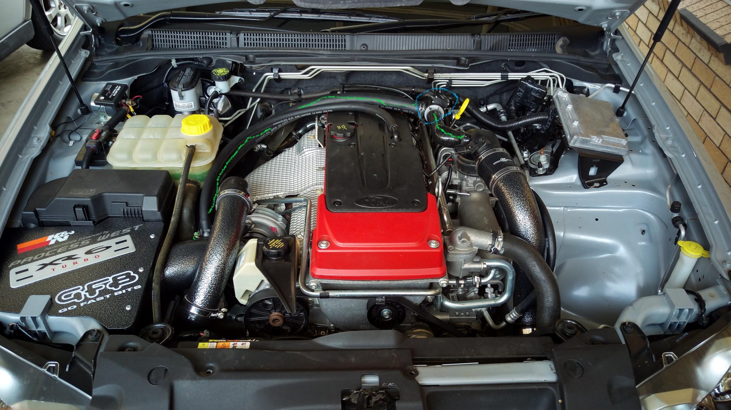

Here's how the BOV is installed with my turbo side kit. (green = hose, blue = BOV)
I'm using a GFB Deceptor Pro adjustable BOV but the stock one will connect up just fine in the same spot

^^ and that's about as good as you can get it from an "unsightly" point of view haha it's a big fat soft hose that just recirculates unused boost.
