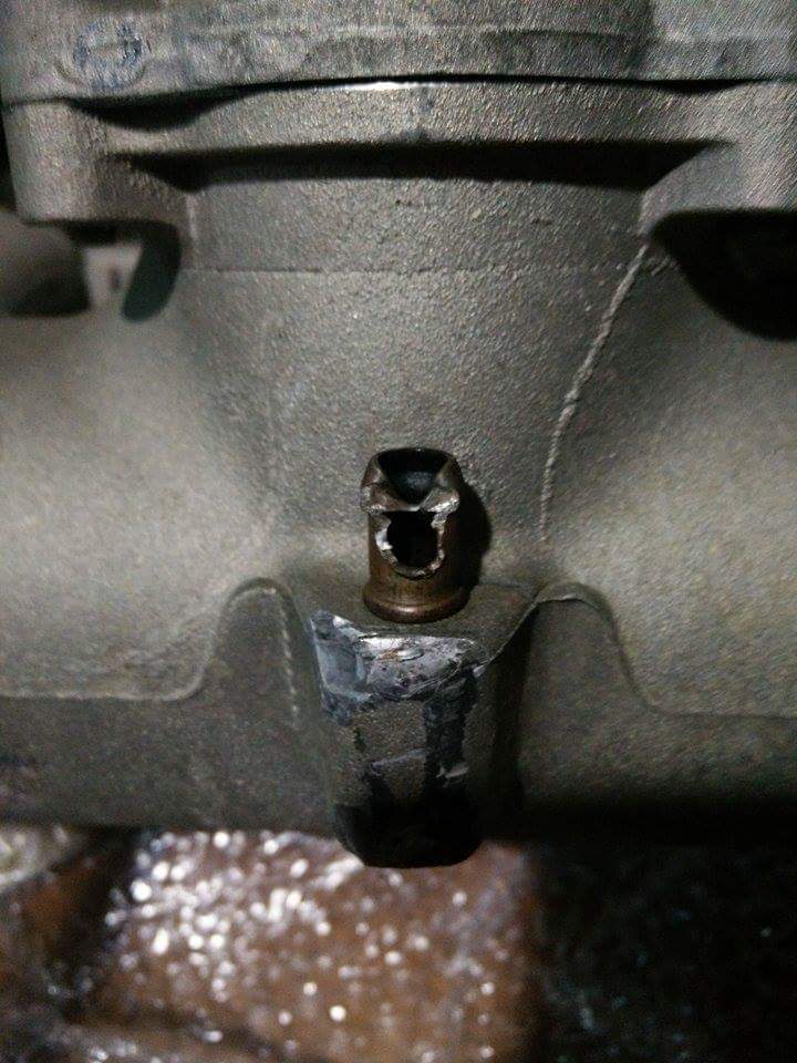

IT15ON Donating Members 83 Member For: 13y 4m Gender: Male Location: Newcastle Posted 10/08/15 12:36 PM Author Share Posted 10/08/15 12:36 PM Sunday arvo we made a start on the car, plan being to get all this new gear on and tuned ready for racing this weekend. First up we wired the FG throttle body in roughly to test.After a quick check all seemed fine, and so the car was pulled apart. After a bit of persuasion the manifold was off and we took a chance to compare the two side by side, you can see just how much simpler the FG one is compared to BF. The throttle body is also a lot different in size, the FG is tiny compared to BF. I can see why guys have bonnet clearance issues running a BF TB with adapter plate on the FG plenum. We are using the FG TB to avoid the issue. The FG plenum was trial fitted but hit the hard lines below the thermostat housing. We found a tool in the shed that would sort this out..... Once the plenum was in the wiring was finalized. BF TB runs two plugs off the loom, whereas the FG is all in the one plug. We had to redo some wiring to make it compatible, but overall worked out being a fairly straightforward job. New KPM 1000cc injectors are also going to make life easier, a full data sheet will be very handy, and they were ordered in FG size so bolt straight in to the FG rail & manifold with no spacers. The whole show bolted in looking a lot neater than the old crossover pipe setup. The new injector data was used along with new FG TB gain settings, before a test start. Got it going first try!!Next step is custom cold side piping to suit then the road tuning begins..... 3 Link to comment https://www.fordxr6turbo.com/forum/topic/90142-bf-mk25-home-build-309rwkw-on-15psi/page/9/#findComment-1557354 Share on other sites More sharing options...

Tocchi Sandtrap Motorsport Donating Members 2,055 Member For: 16y 5m 8d Gender: Male Location: Perth Posted 10/08/15 11:19 PM Share Posted 10/08/15 11:19 PM Re: FG intake, I used the MonstaTorque BF harness to FG TB patch loom, worked a treatAlso, I used BF piping kit (bizpro cobra kit) and extended it to suit FG manifoldRe: turbo manifoldThe cast dump on the FG is shorter, a BF cast dump will foul on the block if you run FG turbo manifold Link to comment https://www.fordxr6turbo.com/forum/topic/90142-bf-mk25-home-build-309rwkw-on-15psi/page/9/#findComment-1557376 Share on other sites More sharing options...
k31th less WHY; more WOT Site Developer 29,466 Member For: 17y 23d Gender: Male Location: Melbourne Posted 10/08/15 11:26 PM Share Posted 10/08/15 11:26 PM Re: BF cast dump - nothing a good hammering won't fix 1 Link to comment https://www.fordxr6turbo.com/forum/topic/90142-bf-mk25-home-build-309rwkw-on-15psi/page/9/#findComment-1557378 Share on other sites More sharing options...
