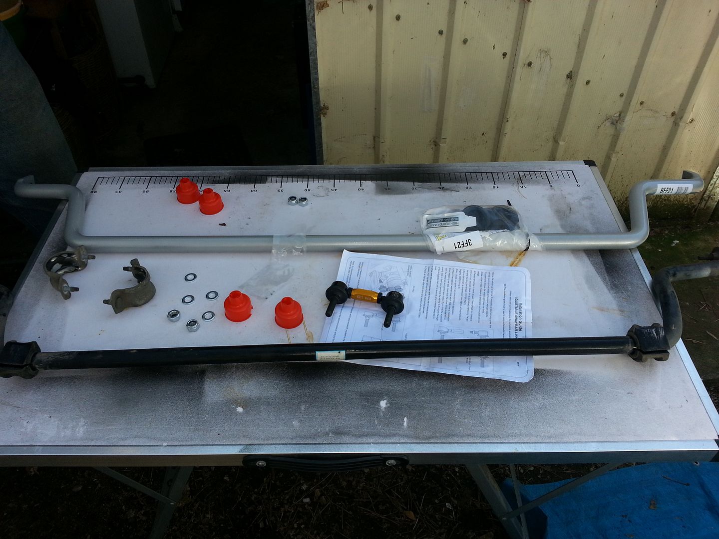

xr6tnv PC LOAD LETTER Donating Members 388 Member For: 13y 8m 10d Gender: Male Location: Melbourne Posted 07/08/14 02:15 AM Author Share Posted 07/08/14 02:15 AM I've had a look around and from what I can see the stock rear sway bar is 19mm ?? Looking at getting some new whiteline d bushes. Link to comment https://www.fordxr6turbo.com/forum/topic/87891-ford-bf-mkii-xr6-turbo/page/17/#findComment-1490846 Share on other sites More sharing options...
Serangan Member 103 Member For: 11y 9m 5d Gender: Male Location: Hobart, Tasmania Posted 20/08/14 01:37 AM Share Posted 20/08/14 01:37 AM Stock ba rear sway bar, suggests 19mm as you said 1 Link to comment https://www.fordxr6turbo.com/forum/topic/87891-ford-bf-mkii-xr6-turbo/page/17/#findComment-1493708 Share on other sites More sharing options...
xr6tnv PC LOAD LETTER Donating Members 388 Member For: 13y 8m 10d Gender: Male Location: Melbourne Posted 20/08/14 03:21 AM Author Share Posted 20/08/14 03:21 AM Fantastic Thanks for the picture mate, much appreciated. I'll grab some whiteline 19mm rear sway bar bushes and try those out. Link to comment https://www.fordxr6turbo.com/forum/topic/87891-ford-bf-mkii-xr6-turbo/page/17/#findComment-1493747 Share on other sites More sharing options...

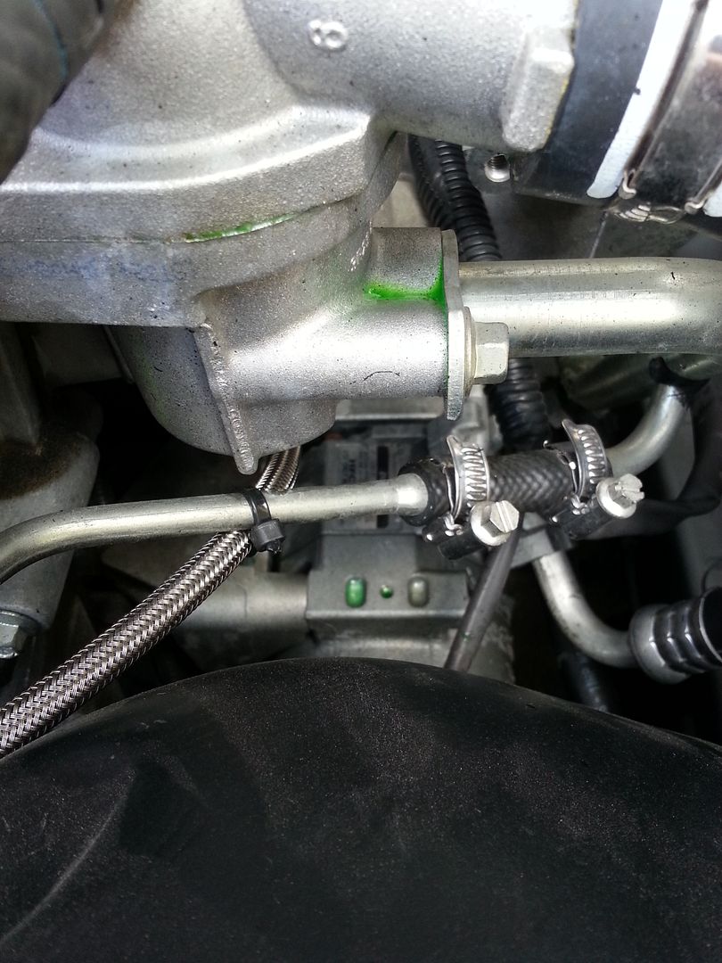

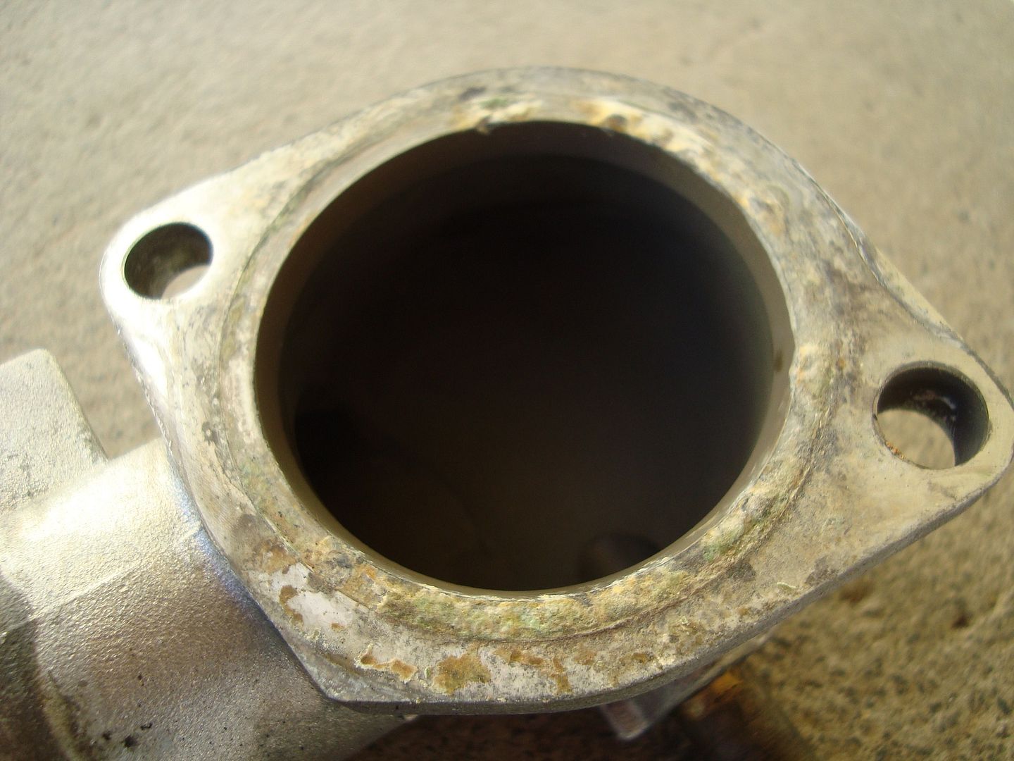

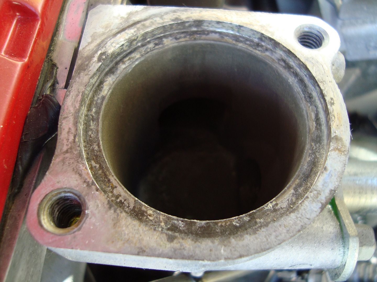

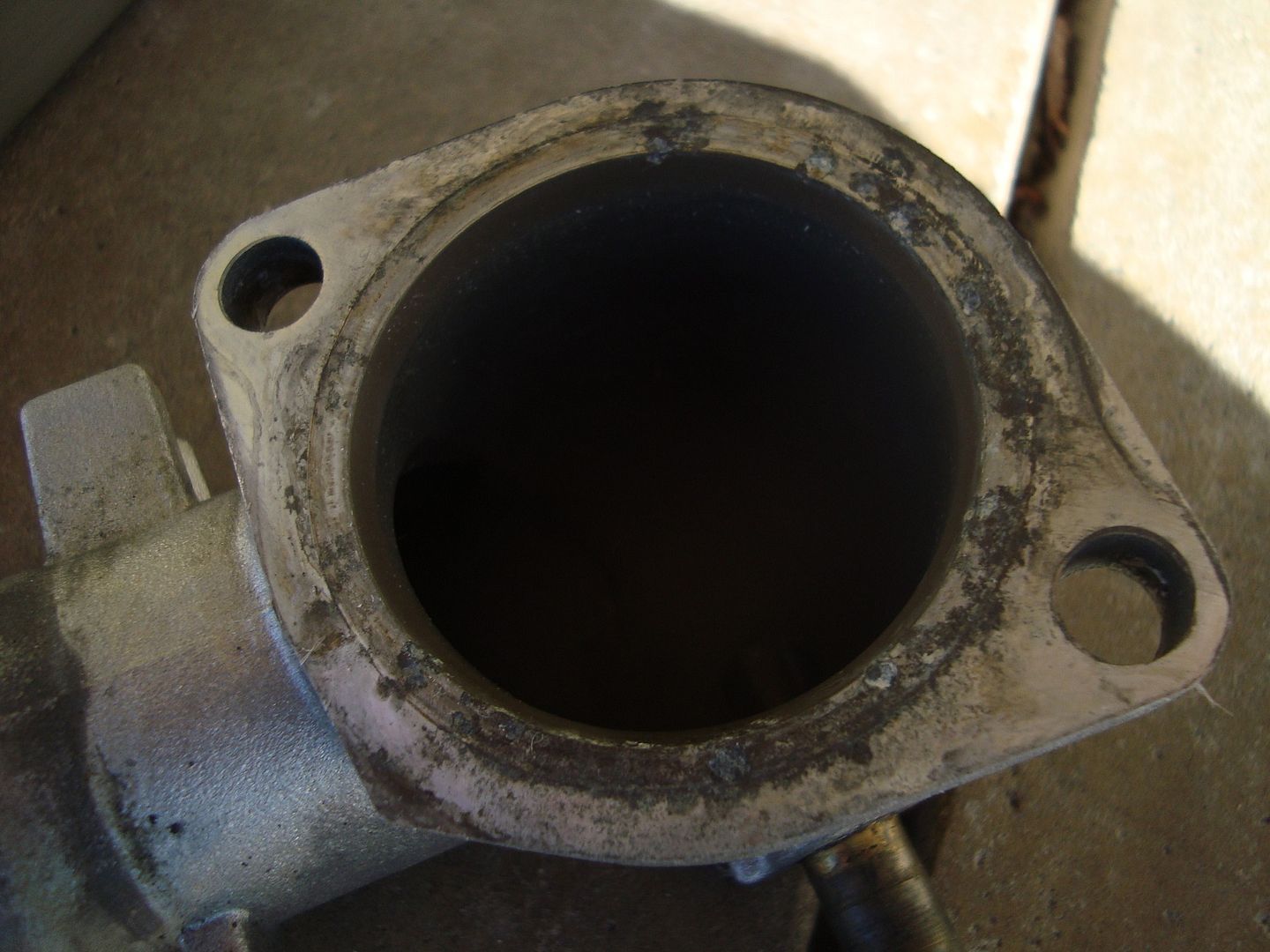

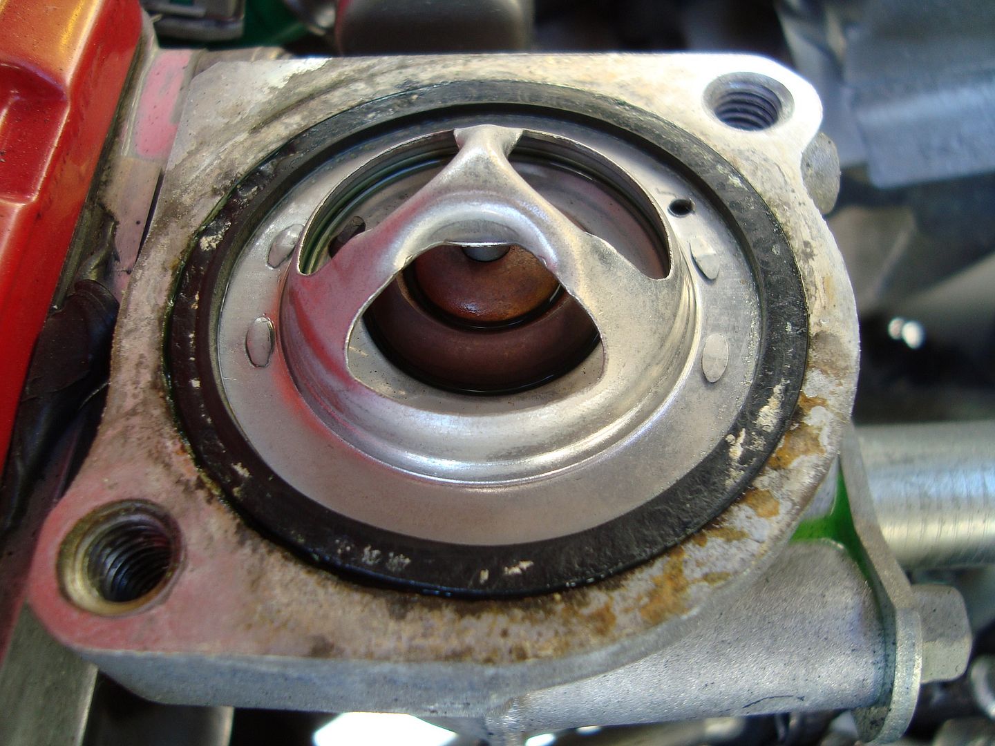

xr6tnv PC LOAD LETTER Donating Members 388 Member For: 13y 8m 10d Gender: Male Location: Melbourne Posted 22/08/14 07:03 AM Author Share Posted 22/08/14 07:03 AM Noticed over the past 2 weeks that the coolant overflow bottle has been dropping a bit of coolant.... So we found the issue and it was slowly leaking from the thermo housing.Bought a new O ring seal to see if that would help and also cleaned up the inside. Ran the car in the driveway for about 20 minutes and it looked all good. Then took it for a drive before and when I parked the car, checked it again and the leak has come back. So now it might be time for a new thermo top half and sand back the bottom piece.Before:After: Link to comment https://www.fordxr6turbo.com/forum/topic/87891-ford-bf-mkii-xr6-turbo/page/17/#findComment-1494428 Share on other sites More sharing options...
xr6tnv PC LOAD LETTER Donating Members 388 Member For: 13y 8m 10d Gender: Male Location: Melbourne Posted 26/08/14 04:11 AM Author Share Posted 26/08/14 04:11 AM Even though the units aren't meant to have sealant around them, this has seemed to stop the leak from the thermostat... Although purchased a the top part of the thermo just in case it starts to leak again. Link to comment https://www.fordxr6turbo.com/forum/topic/87891-ford-bf-mkii-xr6-turbo/page/17/#findComment-1495257 Share on other sites More sharing options...

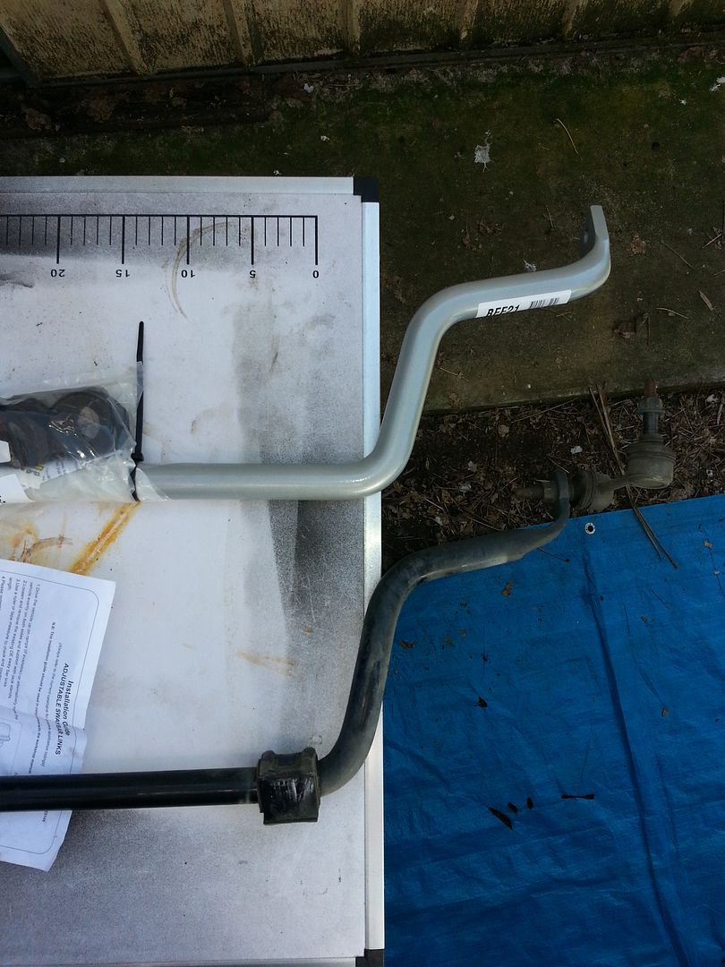

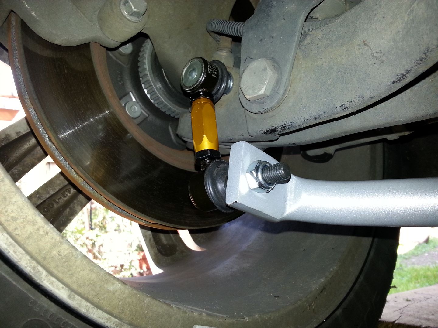

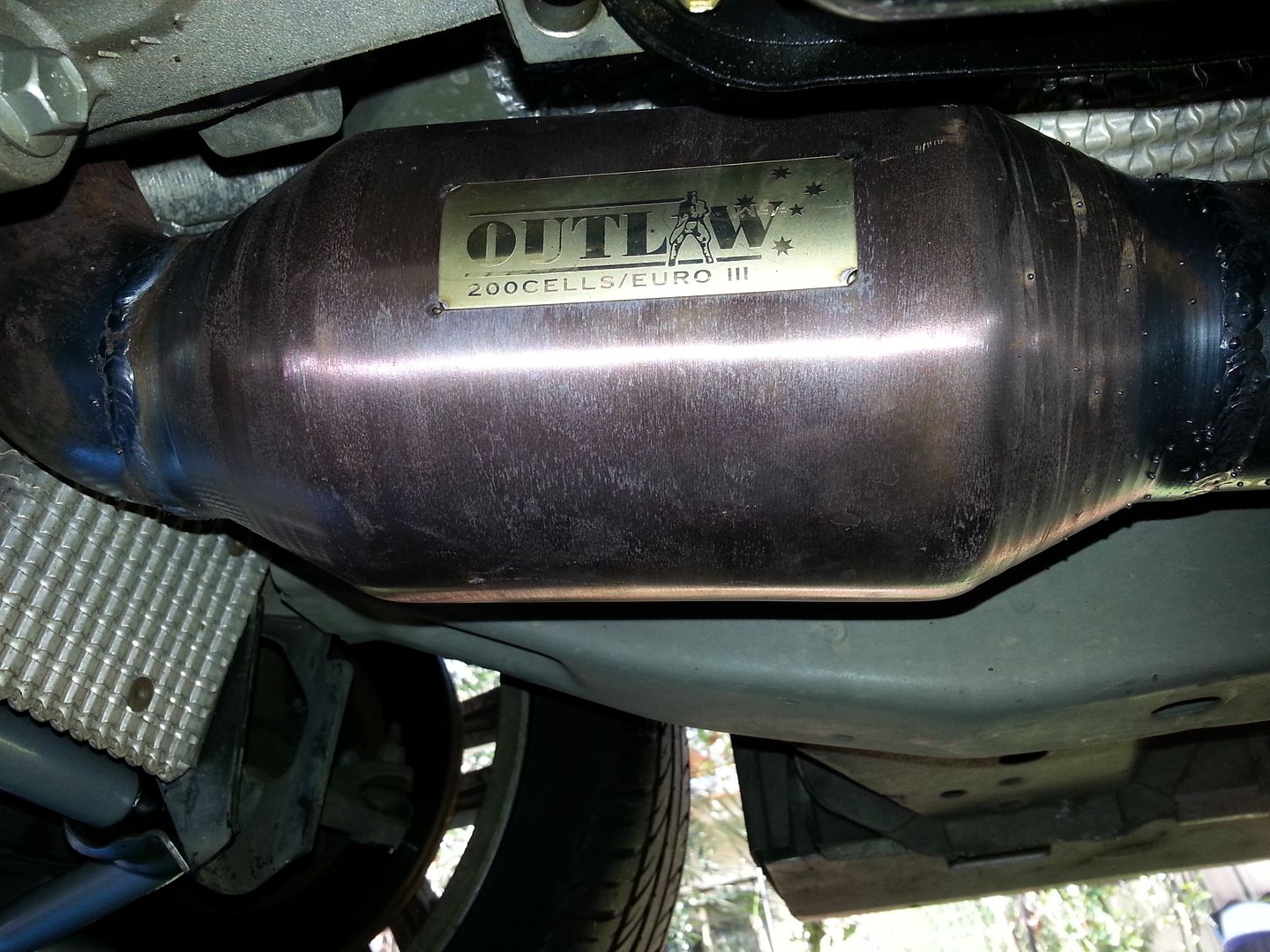

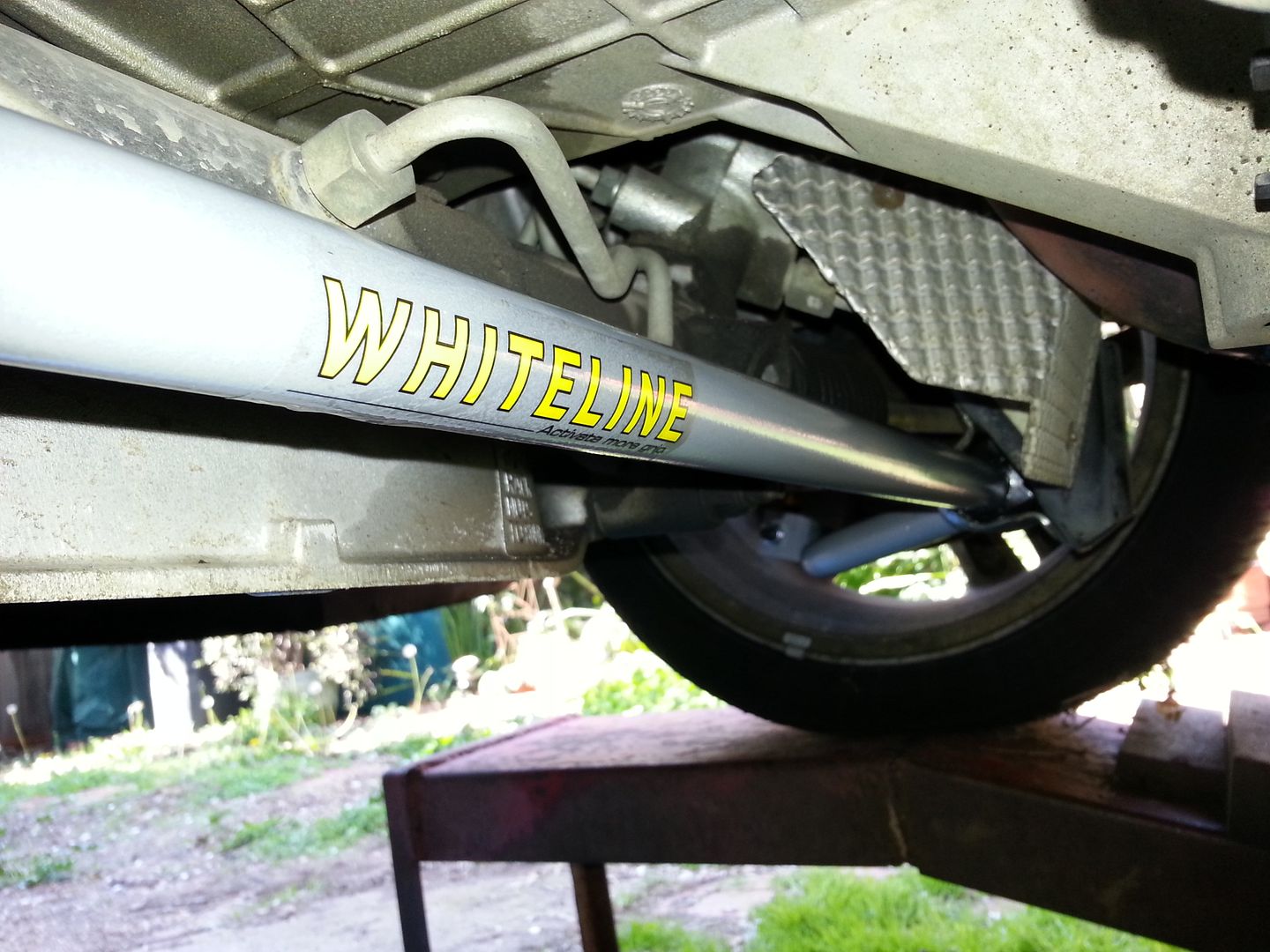

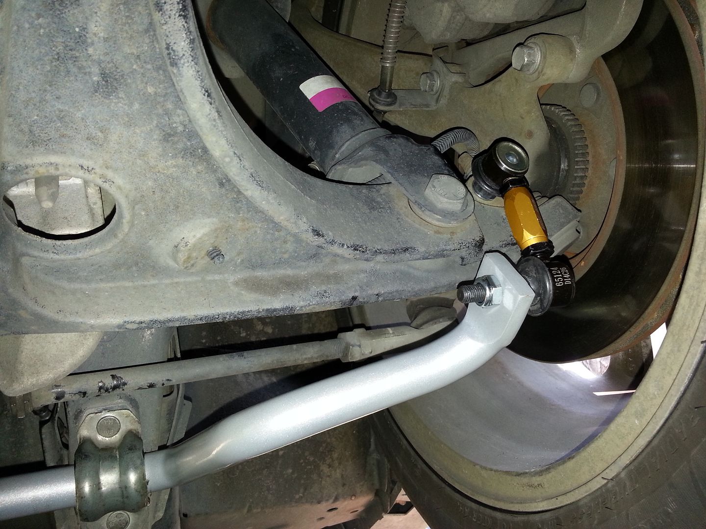

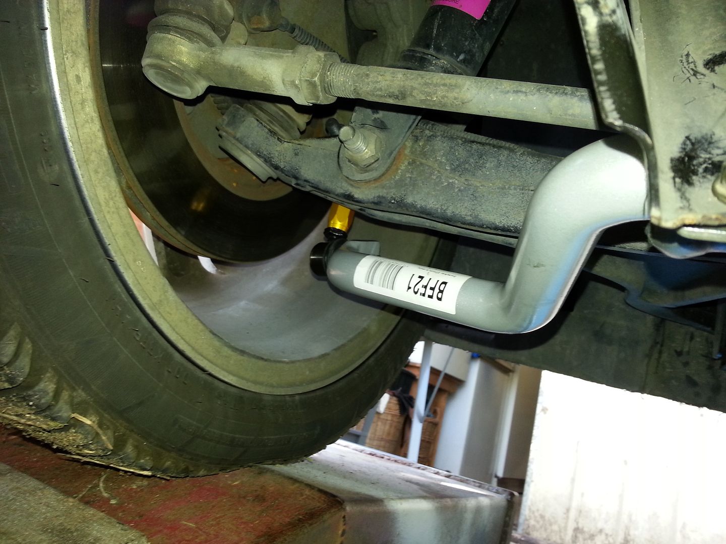

xr6tnv PC LOAD LETTER Donating Members 388 Member For: 13y 8m 10d Gender: Male Location: Melbourne Posted 26/08/14 05:09 AM Author Share Posted 26/08/14 05:09 AM The weather here finally cleared up and it was nice and sunny, so decided to finally put in the front 27mm whiteline sway bar and adjustable link assembly.Taken out the old parts were easy but the real pain in the ass was putting the d shackles back over the new sway bar bushes... Ended up putting some of the bushing lube on the d shackle to allow for them to push a little easier over the bush and hold the sway bar to the frame.Finishing touch... adding the sticker Took the car for a quick drive and seems like there is a difference up front. As many other have found with this upgrade, the front seems a little stiffer and snappier. Overall I'm happy so far with how it has improved the handling.While I was down there, also took a picture of the catalytic convertor fitted up by Pit Lane just in case anyone was interested (5" Outlaw). 2 Link to comment https://www.fordxr6turbo.com/forum/topic/87891-ford-bf-mkii-xr6-turbo/page/17/#findComment-1495271 Share on other sites More sharing options...
xr6tnv PC LOAD LETTER Donating Members 388 Member For: 13y 8m 10d Gender: Male Location: Melbourne Posted 01/09/14 01:34 AM Author Share Posted 01/09/14 01:34 AM So for the past 100km the new sway bar and links have been in the car.... last two days though there has been some loud knocking which seemed to only be getting more frequent ! Started to really annoy the crap out me so just before it rained this morning, got back under the front and torqued both the d shackles and the sway bar links. The d shackles where a little bit loose but then the sway bar links on the lower part were a lot more loose. Once torqued to the ford specs took the car for a drive and the noise had gone and the front end felt a lot more solid again. Link to comment https://www.fordxr6turbo.com/forum/topic/87891-ford-bf-mkii-xr6-turbo/page/17/#findComment-1496528 Share on other sites More sharing options...

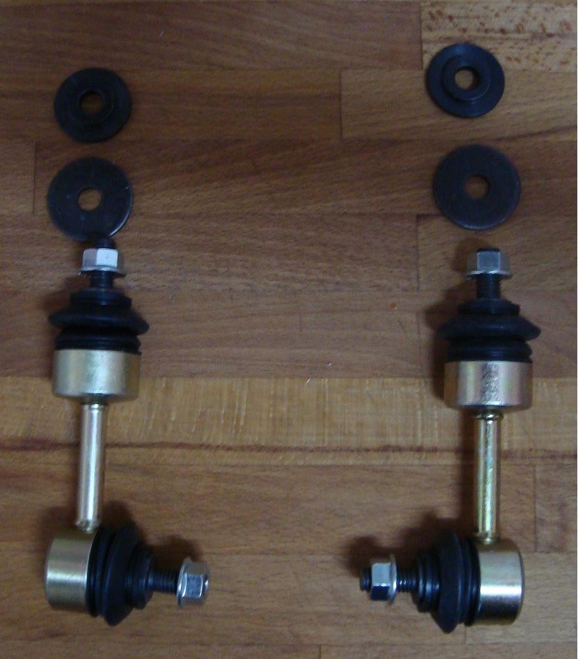

xr6tnv PC LOAD LETTER Donating Members 388 Member For: 13y 8m 10d Gender: Male Location: Melbourne Posted 18/09/14 12:59 AM Author Share Posted 18/09/14 12:59 AM Decided that I didn't want to upgrade the rear sway bar but wanted something better than the standard link pins and bushes so ordered a set from Wholesale Suspension and going to order the whiteline d-bushes. 2 Link to comment https://www.fordxr6turbo.com/forum/topic/87891-ford-bf-mkii-xr6-turbo/page/17/#findComment-1499983 Share on other sites More sharing options...
discostig Manual mode ________________________ All day, erryday Donating Members 13,798 Member For: 17y 7m 3d Gender: Male Location: Probably above atmospheric pressure Posted 18/09/14 06:12 AM Share Posted 18/09/14 06:12 AM Make sure the washers aren't thicker than the frame or you'll get a nice rattle, probably saw that in my posts around the place though. Love mine! 1 Link to comment https://www.fordxr6turbo.com/forum/topic/87891-ford-bf-mkii-xr6-turbo/page/17/#findComment-1500061 Share on other sites More sharing options...
xr6tnv PC LOAD LETTER Donating Members 388 Member For: 13y 8m 10d Gender: Male Location: Melbourne Posted 18/09/14 08:55 AM Author Share Posted 18/09/14 08:55 AM Spot on Steve saw that in your build thread and the thread from wholesale suspension. Made sure I understood what was going on with them before anymore rattles occured, the loose front end linkages caused enough frustration. Im looking forward to a firmer rear end Link to comment https://www.fordxr6turbo.com/forum/topic/87891-ford-bf-mkii-xr6-turbo/page/17/#findComment-1500119 Share on other sites More sharing options...
