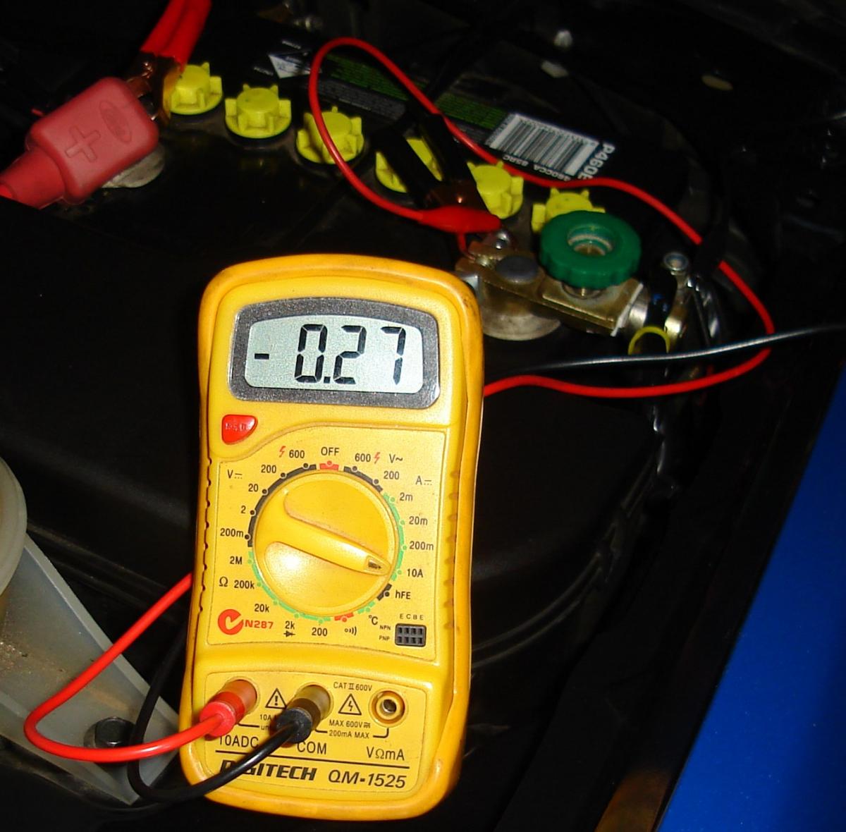

f-wolf Member 897 Member For: 19y 5m 14d Gender: Male Location: ACT Posted 29/01/14 06:07 AM Posted 29/01/14 06:07 AM (edited) I just spend an hour under the house in the garage doing some tests... My Car: 2005 BA MK2 Turbo 6 Speed Manual. This is what I did: No Key in Ignition 1x Digital Multimeter set to measure Amps...Set to 10A Disconnected Neg. Battery Cable 1 Probe Wire to Battery -, 1Probe to Battery Cable... I used clips to hold them in place. Open and close Driver Door... Wait till interior lights go out to get 1st Meter reading. In my case it was 0.27 Amp. After waiting for 15 Minutes the reading changed to 0.08 Amp. All of that tells me that the my BEM is working. http://postimg.org/image/ndph6ib99/ Edited 29/01/14 06:13 AM by f-wolf 1

f-wolf Member 897 Member For: 19y 5m 14d Gender: Male Location: ACT Posted 31/01/14 01:54 AM Posted 31/01/14 01:54 AM Hi there Ralph When I did my Meter Test... I left it [Meter] hooked up over night... Next morning Meter was still showing 0.08Amp.
Ralph Wiggum Moar Powar Babeh Legacy Donating Member 19,334 Member For: 21y 16d Gender: Male Location: Perth Posted 31/01/14 03:05 AM Posted 31/01/14 03:05 AM .08 wouldn't stress me too much. Don't forget the PCM also has KAM (keep alive memory) that's a constant power feed to the pcm to (you guessed it) keep the memory alive.
