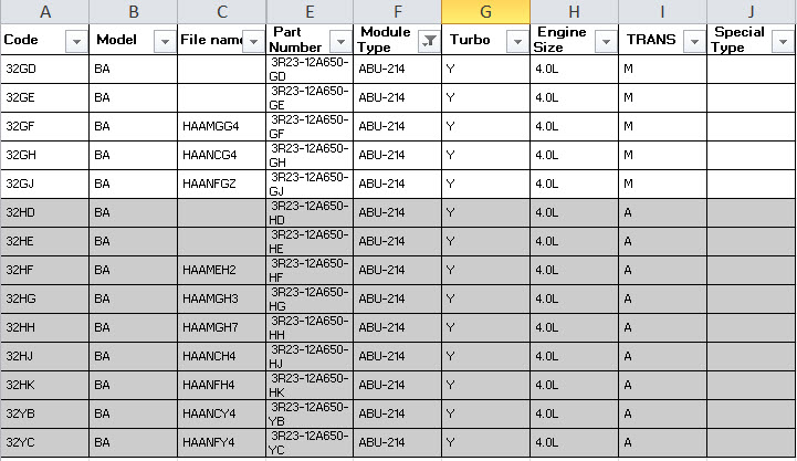

Ralph Wiggum Moar Powar Babeh Lifetime Members 19,332 Member For: 19y 7m 16d Gender: Male Location: Perth Posted 19/10/13 11:38 PM Share Posted 19/10/13 11:38 PM give them a ring, you need the tear tag info from the PCM as an ABU-214 will function as a manual or auto pcm.Tear Tag number will be a four digit code similar too the pic:List of possible ABU-214 Software Versions (courtesy of Bullet performance) List of BA/Turbo/Auto Software Versions (again courtesy of Bullet Performance) 1 Link to comment https://www.fordxr6turbo.com/forum/topic/86551-ecu-fried-itself-struggling-to-find-a-replacement/#findComment-1434659 Share on other sites More sharing options...
