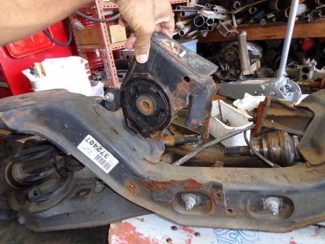

turbotrana Member 2,586 Member For: 22y 3m 9d Gender: Male Posted 21/10/13 03:01 PM Share Posted 21/10/13 03:01 PM And so I went and put a Cat grade million bolt in and guess what, it didn't break...... 1 Link to comment https://www.fordxr6turbo.com/forum/topic/86542-constant-diff-bolt-breakage/page/3/#findComment-1435039 Share on other sites More sharing options...

Ralph Wiggum Moar Powar Babeh Lifetime Members 19,332 Member For: 19y 9m 16d Gender: Male Location: Perth Posted 22/10/13 01:40 AM Share Posted 22/10/13 01:40 AM And I suppose there was no cracks in that cradle before you installed the milliom grade bolt? Link to comment https://www.fordxr6turbo.com/forum/topic/86542-constant-diff-bolt-breakage/page/3/#findComment-1435120 Share on other sites More sharing options...
RIP85 REST IN PEACE V8 Donating Members 469 Member For: 17y 2m 18d Gender: Male Location: Woodridge on the park bench Posted 22/10/13 02:26 AM Author Share Posted 22/10/13 02:26 AM I have a new cradle when the diff went last year it twisted the cradle and smashed the diff Link to comment https://www.fordxr6turbo.com/forum/topic/86542-constant-diff-bolt-breakage/page/3/#findComment-1435142 Share on other sites More sharing options...

turbotrana Member 2,586 Member For: 22y 3m 9d Gender: Male Posted 22/10/13 12:16 PM Share Posted 22/10/13 12:16 PM And I suppose there was no cracks in that cradle before you installed the milliom grade bolt?Not my cradle. I'd be too embarrassed to show that if it was mine.I never met the guy I got that off but it certainly takes a special kind of guy to get it to that point. Link to comment https://www.fordxr6turbo.com/forum/topic/86542-constant-diff-bolt-breakage/page/3/#findComment-1435284 Share on other sites More sharing options...
