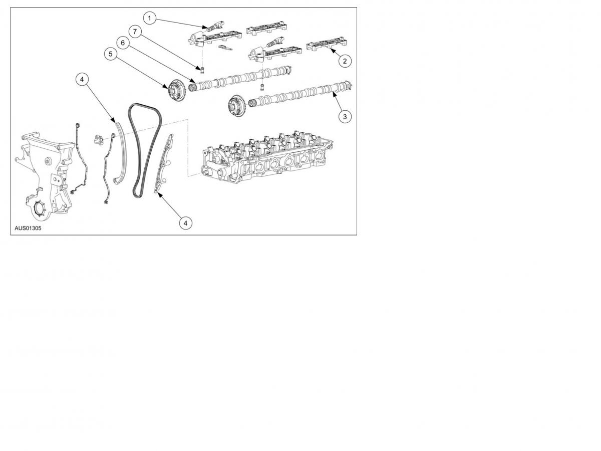

Pop the rocker cover off and have a look. refer to the pic and it should be quite easy to determing which cam is which. Not the notch in the cam and postion of the cam angle sensor triggers.
