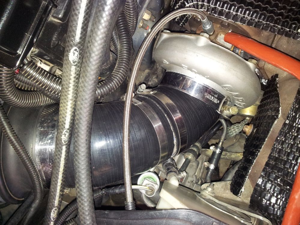

skap Member 10 Member For: 14y 4m 13d Posted 02/08/13 07:40 AM Posted 02/08/13 07:40 AM I recently whacked on a new GTX on BA xr6t and wondering if anyone can upload a couple pics of what they're using for a 4" air intake?Just wondering how the best way of going about it is.Thanks

skap Member 10 Member For: 14y 4m 13d Posted 02/08/13 08:11 AM Author Posted 02/08/13 08:11 AM yeah already have an APS cooler setup with battery relocation, but now the gtx is in, I need a new intake. It just doesn't leave much room for a 4" elbow to clear the p/steer pump.
bossmang FREAKY Legacy Donating Member 12,441 Member For: 16y 8m 29d Gender: Male Location: Melbourne Posted 02/08/13 08:25 AM Posted 02/08/13 08:25 AM yer its pretty darn tight but can be donejets car with staino air box, same as mine and I have gtx

Skids4kids in the mid....not the bum like some Member 609 Member For: 13y 5m Gender: Male Posted 02/08/13 03:04 PM Posted 02/08/13 03:04 PM Being a B series no off the shelf 4" intake kit will fit without rubbing even though some places will sell them to you....not sure how they get away with selling F series parts to B series customers.The FG's have the turbo sit 30-40mm back closer towards the firewall so a 4" intake is a breeze.If you want one that doesn't hit the power steering sensor/hard line then it will need to be made yourself like I did.
skap Member 10 Member For: 14y 4m 13d Posted 03/08/13 05:33 AM Author Posted 03/08/13 05:33 AM You're right skids, theres no kit you can buy that will fit straight on a B series!I ended up using a plazmaman 4" pipe and chopping up a 4" silicone elbow and threw my airbox over the top of it. Somehow it just fits, didn't think it was going to be that easy.Drives much smoother and sounds betterI'll upload some pics if it will help anyone else in the futureThanks everyone for your help! 1

Skids4kids in the mid....not the bum like some Member 609 Member For: 13y 5m Gender: Male Posted 03/08/13 12:29 PM Posted 03/08/13 12:29 PM Has about 2mm clearance on the pressure switch and about 10mm on the hard line underneath:)
