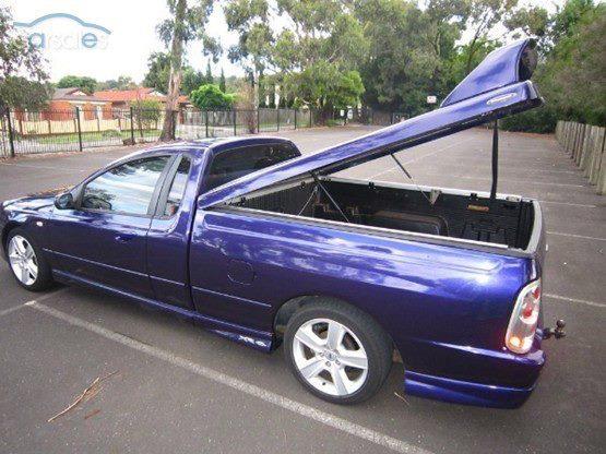

post-51065-0-43780400-1336037993_thumb.jhi everyone, I have a problem, I need help as I dont want to get ripped off, anyway I own a 2003 BA XR6 Turbo ute 4 speed auto, today when driving I lost power, I put my foot on it and nothing, I had no power, but the engine was still running, I put my foot down again and the engine didnt even rev, but it was still running. I rolled to a stop tested reverse, fine, but then I noticed that the D was flashing, I turned it off and then back on and drove off, everything was fine, how ever it another 2 times on the way back home each time it done it the D would flash off and on! . So now Im pissed off....it has had a service not to long ago and only has 112000ks on it, can someone tell me if it could be a sensor playing up. regards me :)
