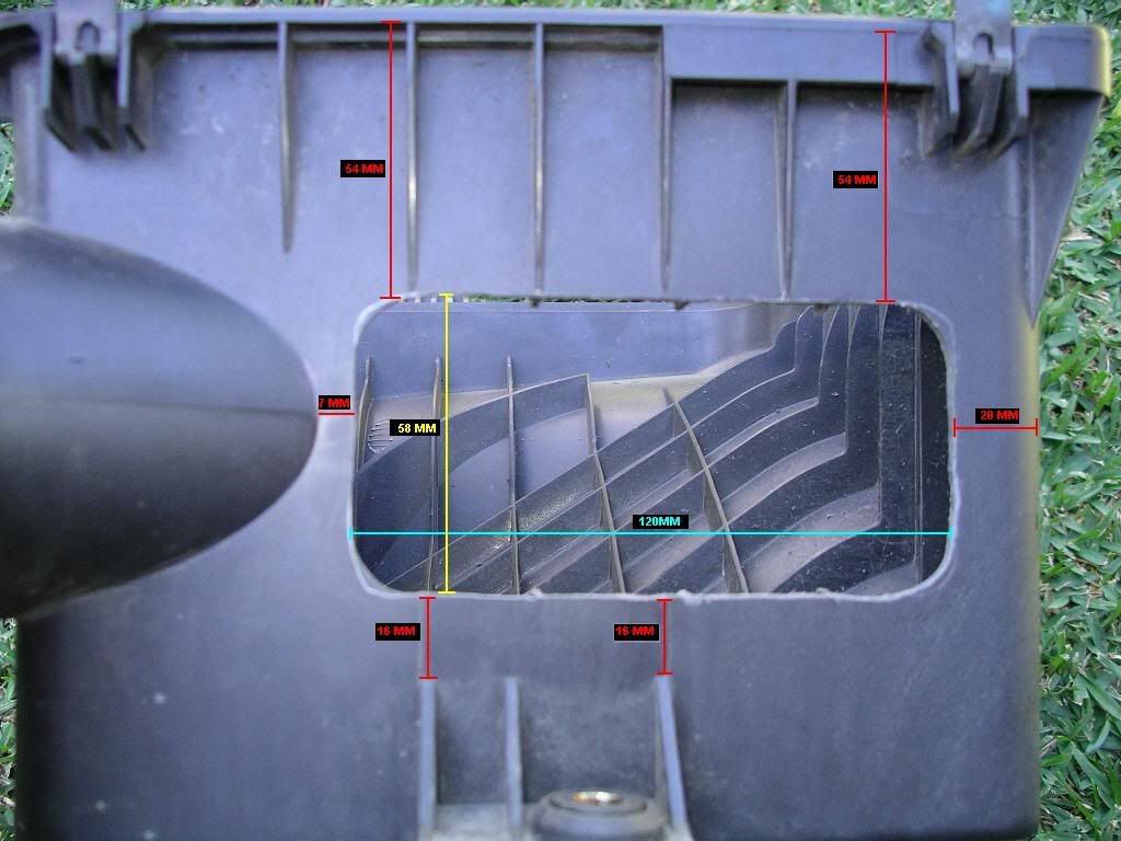

h20boynz Member 11 Member For: 14y 4m 13d Posted 19/12/10 04:50 AM Author Share Posted 19/12/10 04:50 AM Anyone have a picture of the F6 snorkel mod...just so I know what the part looks like. I can just imagine the blank looks on the faces of the guys at my local ford dealership whebn I walk in there asking for one of these Link to comment https://www.fordxr6turbo.com/forum/topic/72234-03-xr6t-bog-standard-making-a-start/#findComment-1064921 Share on other sites More sharing options...

sexual harrassment panda I see a red door and I want to paint it black Donating Members 5,919 Member For: 15y 6m 5d Gender: Male Location: Far north queensland Posted 19/12/10 11:10 PM Share Posted 19/12/10 11:10 PM That should help. Ask for a BF XR8 lower snorkel from your local dealers Link to comment https://www.fordxr6turbo.com/forum/topic/72234-03-xr6t-bog-standard-making-a-start/#findComment-1065057 Share on other sites More sharing options...
