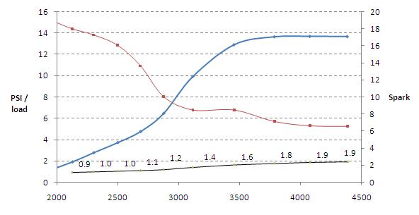

IH8TOADS Silver Donating Members 3,618 Member For: 19y 9m 23d Gender: Male Location: OZ Posted 13/01/10 09:21 AM Share Posted 13/01/10 09:21 AM (edited) I always log directly to the laptop with livelink...well live!! and as you mentioned I export in csv and then analyse everything in excel afterwards anyway. Attached is an example output of a quick 3rd gear run. Edit: boosts comes on late because I haven't stompted on it hard, I see max boost at exactly 3000rpm on the street. Edited 13/01/10 09:22 AM by IH8TOADS Link to comment https://www.fordxr6turbo.com/forum/topic/62430-data-logging/page/3/#findComment-970472 Share on other sites More sharing options...
