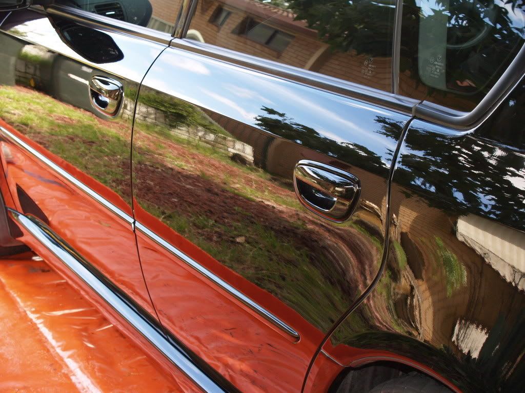

dms_dan Member 29 Member For: 18y 5m 5d Posted 18/04/08 12:02 AM Posted 18/04/08 12:02 AM Hey Guys and Girls,Ive been reading some of the past threads here and thought I would outline some stuff for you.The biggest misconception I come across in detailing is people that dont understand the difference between waxing and polishing. I can see how they get confused, its the care care product manufactures fault mostly. Anyway here you go.PolishingPolishing is used to fix paint defects. Polishes can be either chemical or abrasive.Chemical polishers include things like Swissvax cleaner fluid, polylack nano clean, zymol HD Cleanse. They chemically clean the surface to remove contaminants and defects. They will not remove swirl marks. For this you need an abrasive polish.Abrasive polishThere are many brands. The best I have used is Menzerna. But the meguiars professional range is abrasive as is the optimum polishing range. Abrasive polishes need a machine to reach their full potential. Either a random orbital or a rotary. Abrasive polishes have tiny little abrasives suspended in the liquid. This is what does the work the size and type of abrasive varies depending on the polish you use. The abrasives round the edges of the scratches and swirls so they can no longer be seen. In the case of swirls and fine scratches they are removed. In the carse of deep scratches they are always reduced and with the use of wet/dry sand paper can be removed. Menzerna Powergloss has large abrasives which remove large defects but leave the surface full of marring and quite dull. Then there is menzerna intensive polish this is between the two but on most colours needs to be followed with final finish. This depends on the pad used. Menzerna Final Finish leaves the surface free from defects and with a great depth and shine. Here are some pics so you can see the differenceAfter powerglossAfter Intensive polishAfter final finishWaxingWaxing is the last step you do when washing or detailing your car. That is why you may see it referred to as the LSP (last step product). The purpose of waxing is to create a barrier between your paint and the environment. Most waxes contain UV inhibitors to stop the sun damaging the paint. They also repel water which stops your paint getting etchings from watermarks. There are many may different LSP's out there both natural or synthetic or even a mixture of both. Natural waxes tend to give more of a warmth and a glow. These waxes range in price starting at around $50 and up to $19000. Brands include Swissvax, Zymol, P21S, Dodo and many many more. These are the boutique brand waxes. You can get off the shelf waxes but I dont rate them for durability or look personally. If they are working for you then go for it! Natural waxes also tend to bead water. This means the water forms tight little beads that run off very easily. If you have a freshly waxed car and drive it in the rain you will find the water will just run off. The lower end waxes and off the shelf waxes last 3-5 weeks before needing to be reapplied whereas the higher end can last 6-8 weeks. SyntheticSynthetic products do not contain wax. They, for the most part contain polymers or acrylic. These are the two main types of sealers. Sealers include Zaino Z2 and Z5, Polylack Nano seal, Optimum opti seal, Klasse AIO, Zaino AIO. Sealants start at around $35 for the boutique brands. I have found Zaino to be the best as it can be layerd unlimited times but still remains optically perfect if you use Z2. Z5 will not as it has fillers to hide swirling.Sealants give a different look to wax. It gives a look that is best described as sterile. The paint is shiny but it lacks the warmness and glow of a natural wax. Some sealants like the Klasse make the car look like it has a plastic coating. Some people love this look so leave it others, like myself, don't and then top it with a natural wax.Synthetics tend to sheet water. The water wont form beads, rather it will just run off in a sheet is the best way to describe it. Sealants leave a very slick and slippery surface. Sealants also last a lot longer than a wax with most giving at least 3 months protection and up to 12 months for layered sealants. Combination waxesThese have a mix of both natural and synthetic waxes present. These are waxes like Optimum car wax (OCW). They are a good compromise as they give the look of a natural wax and some of the durability of a sealant. Layered OWC can last 3-4 months. Filler waxesThese are waxes like Meguairs NXT range. They contain things called fillers which fill swirls and scratches. The fillers also mute the metallic in the paint so it wont pop as much. As the product wears off the defects return. I dont like filler products as they wear off and the surface looks bad again. This car has natural wax (Swissol Scuderia ~$200)This one has Zaino Z2 Pro layered 3 times and topped with Z8I hope that helps with any confusion you guys have and if you have any questions ask away!

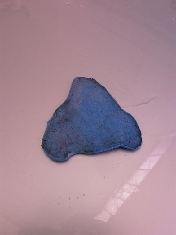

dms_dan Member 29 Member For: 18y 5m 5d Posted 18/04/08 01:01 AM Author Posted 18/04/08 01:01 AM (edited) Great write up mate.These days when you pop down to the local auto shop to buy some products to enhance/protect your car, you leave more confused than when you got there. Whatever you buy and spend the 1,2, 3 or however many hours it takes always looks good ....... just not for long (most times sh**House after the first wash)two questions for you1. you obviously do this for a living, if so where are you based?2. what's your opinion on clay bars (I think that's what they are called) and at what point in the process should they be used.cheersAnthonyThanks mate. Yeah im in Sydney. Dont want to break any forum rules but cause im not a sponsor so wont say anything else at this stage. Clay bars are great! They are used after washing and before polishing to remove anything that has bonded such as sap, bugs, over spray etc. Make sure you use lots of lubricant when claying to ensure it dosnt marr the surface. If your paint feels rough then it needs a clay. Make sure you fold it into itself frequently to endure your not pushing round contaminants. Here is a pic of a clay bar after half the roof of a Ferrari 360 challenge, the roof isnt big either lolThanks for that info that was a good read, I'm a crazy detailer with my car my wife hates it when I tell her I'm going to clean the car as she know I'll be a few hours. Personally I stick with Meguairs NXT range & other product.If the NXT range works for you stick with it! The best product is the one you like the most Edited 18/04/08 01:03 AM by dms_dan

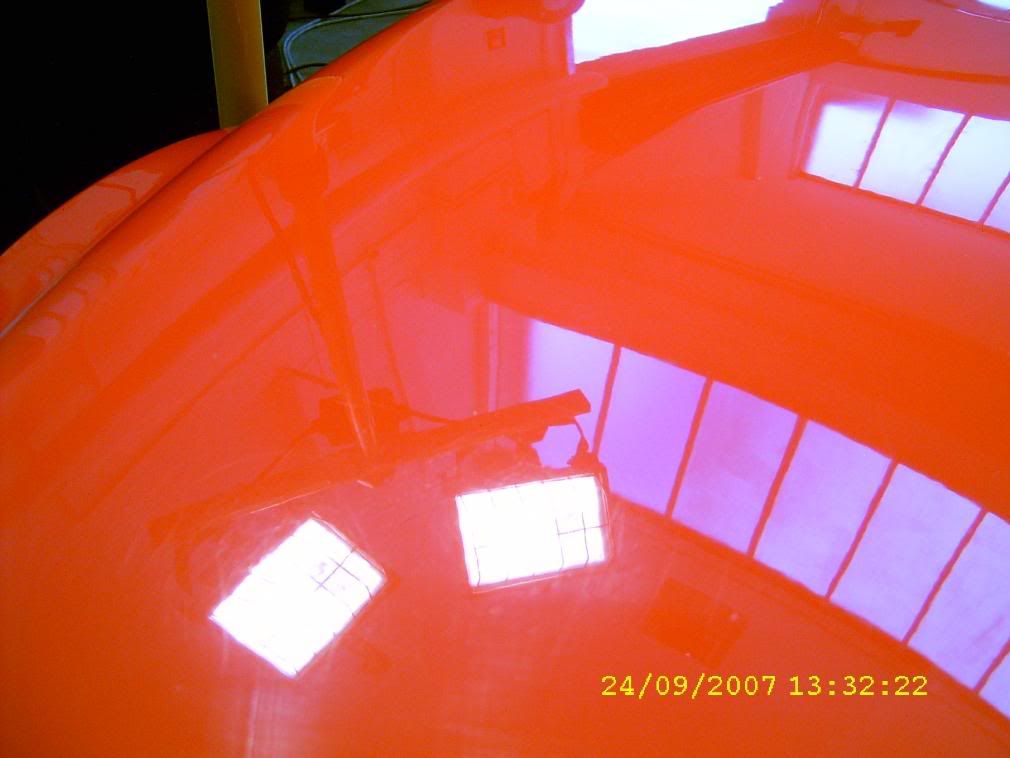

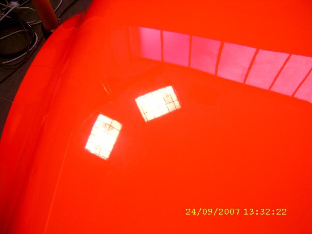

illusionzzz Member 180 Member For: 20y 9m 7d Posted 18/04/08 02:06 AM Posted 18/04/08 02:06 AM Wow that Zaino one looks amazing! Thanks for the good post dan. I need some advice though. I wash my car regularly but am not certain how to get the paint to pop. In the past I've used turtle wax, meguiars gentech etc etc. She hasn't had a polish or a wax for a while, what would you reccomend I do and in what order?
dms_dan Member 29 Member For: 18y 5m 5d Posted 18/04/08 02:18 AM Author Posted 18/04/08 02:18 AM Read the rules before you answer that one Dan....and lock your Photobucket account that Superman outfit does you no justice at all.... Edit: whered those posts come from... I did mate. I dont want to get anyone offside. that's why I didnt give any specific info about myself. Also the spiderman dude is my best mate lol That was at my party but. Wow that Zaino one looks amazing! Thanks for the good post dan. I need some advice though. I wash my car regularly but am not certain how to get the paint to pop. In the past I've used turtle wax, meguiars gentech etc etc. She hasn't had a polish or a wax for a while, what would you reccomend I do and in what order?To get it to pop it needs to be a flat finish. I would suggest wash, clay, polish (if your up to it do it by machine or get a pro) otherwise do it by hand, if you dont want to polish just use paint cleaner by hand then follow up with a wax.
