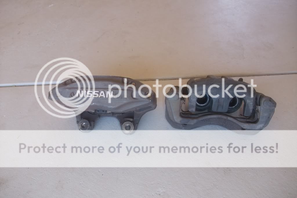

F6 UTE - Track Bound EVO III - Member 3,367 Member For: 20y 5m 1d Gender: Male Location: Strapped in and holding on Posted 04/03/10 01:10 PM Author Share Posted 04/03/10 01:10 PM Finally convinced someone here to tune the thing in the next two weeks... We'll see how it ( if ) it pans out.. Then it may just be off to get some E85 loving from some Ford tuner guy here is WA Also got around to fitting up the 324mm custom brake coversion (finally)Brake conversion consists of:GTR 324mm x 30mm rotors (went with DBA 4000's, redrilled).. Increased offset (58mm Vs 45mm) sets the caliper back nicely and there's no need for those chunky 25mm spacers used with Brembo / 3000GT caliper conversions. Just needs 3-4mm ground from the lower control arm to make it snug.. Nissan R33 gts-t 4 pot calipers Custom fab brackets - just need cuttingHere is the new rotor V stockCaliper differencesBrackets (this is a pik of a very similar set to what I need - mine need three top 'holes' to be near on in a perfect line.)Will CAD up some after I get the dummy set 100%Install - dummy fit.I will grind off 'Nissan' and paint them up in the obligatory VHT red & a clear coat. Also will run a 4mm spacer (which I've been running since I bought it) to give a bit of breathing room between rim / caliper. It fits at a push, but I don't need to push..Some new brake lines and bingo - cheap a$$ 324mm 4 pot conversion... Link to comment https://www.fordxr6turbo.com/forum/topic/43552-new-track-toy/page/17/#findComment-987961 Share on other sites More sharing options...
