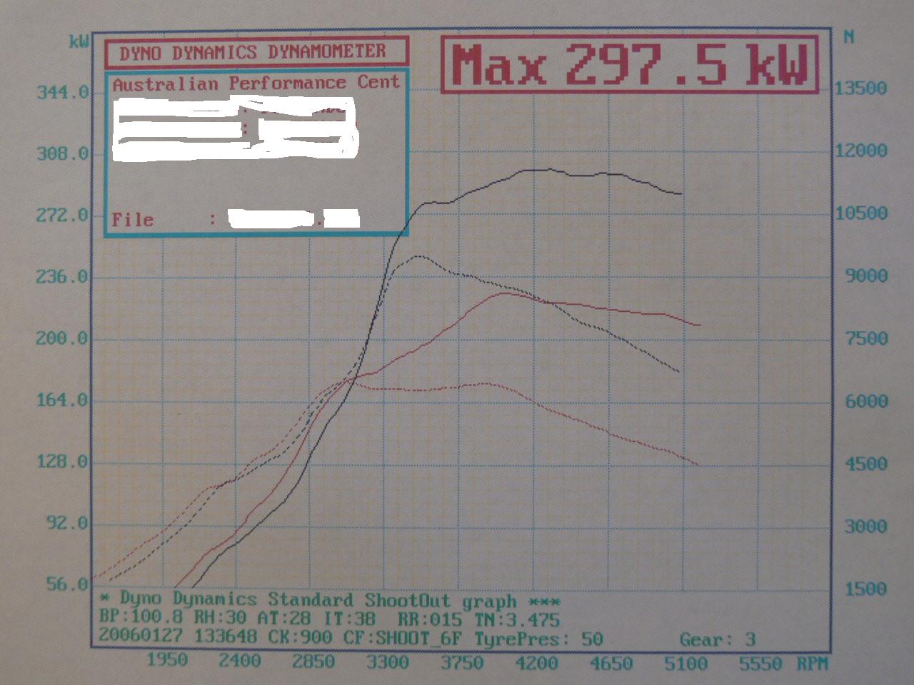

I had the priviledge of tuning a BF Tornado 6-speed auto ute from one of the Perth forum members yesterday, with Barry from BPT Motorsport in attendance as well.
The ute had approximately 400km's on the odo and put down a baseline of 225rwkw in stock trim. With the addition of bigger injectors, bigger dump pipe, twin cats and a cat back system and a retune it now pumps out a healthy 297.5rwkw :nono: It makes a calculated 750nm at the flywheel now, with the stock power output showing bang on 550nm.
On the road the ute went like a cut snake, until a hose from the turbo blew off. That was soon rectified. The power delivery with the auto is truly phenominal, and doesn't stop pulling. I'd say a 6-speed manual with the same power, or even a little more, would have a hard job keeping up with the auto - from a standing start or on the roll.
Graph is attached.

Wow - great results from minor mods. Thems some steep curves!
I don't claim to be any dyno seer but it looks to me like there's little point revving beyond 5000rpm, let alone 6000????

This all came about a bit sooner than I would have expected as I removed my old Stainless exhaust of my BA F6 and had it fitted to this new one and that’s where it all went pair shaped.
We did a dyno run before and after changing the exhaust and the vehicle became un-drivable with just the exhaust change as it would overboost and spit the dumby.
The dyno went 226rwkws in shootout 6 mode. (Factory map)
A/F were @ 10.5
Boost peaked @ 9psi
Then on the dyno 1 hour later with exhaust fitted it went 265.6RWkws in shootout 6 mode. (Factory map)
A/F went to 14.5 at 4500rpm (were fine until @ 3000rpm)
Boost was OK up to @ 3000RPM then climbed to 12PSI.
Needles to say I couldn’t/wouldn’t drive it on the road as it was with the A/F and over-boosting on the factory map.
This lead to having a tune done to get the A/F and boost back under control so the Ute was drivable (Safe to drive). Id like to Thank Barry for taking the time to help out on such short notice as he is so busy atm.
As Jason has indicated, she only had 400km on the clock so when Barry Batton and Jason did a safe map for me they did it with caution and didn’t try and screw the guts out of it and came up with probably the smoothest map I’ve had.
The auto can be a tricky beast on the dyno as it wont Lock into gear so the ramp-up can vary slightly, also we tried it in 4th and came up with the same rwkws but when the speedo hit 220kmh the dyno operator said that’s enough and didn’t want to take it any higher hence the 3rd gear which seems to be what everyone else is using.
