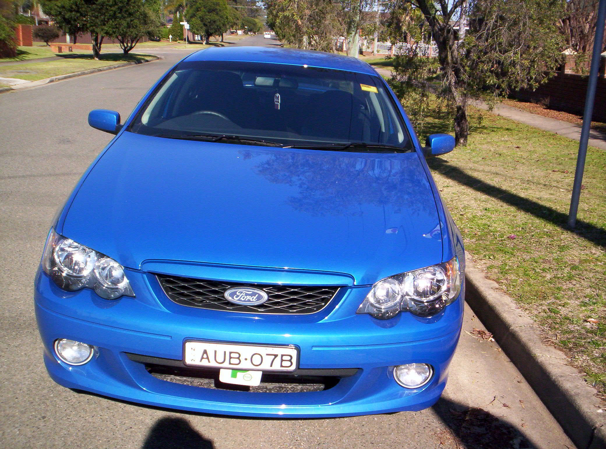

Guest schhhtodd Guests Posted 15/07/05 01:31 PM Posted 15/07/05 01:31 PM alright heres how things are, before calling the dealer I thought I should come ask you guys as you will probably know whats up with the thing, I took her out today with a couple mates, thought id give it some, hit 60 still in 1st when all of a sudden my revs kept goin up but my speed wasnt, I changed into 2nd and same thing, all of a sudden I hear a pop kind of sound and she bit in again and soon an awful smell came through the ventsheres a couple pics of it since I got it almost a month ago and havent posted any yet
