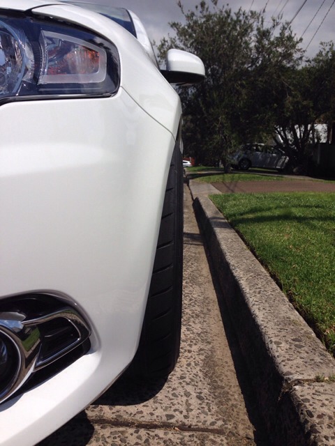

Varrstoen 2.2.2 19x9.5 +22 all round Nitto nt05 245/35r19 front Sunny 265/30r19 rear (don't recommend) Guards not rolled, front factory rolled Sent from my iPhone using Tapatalk

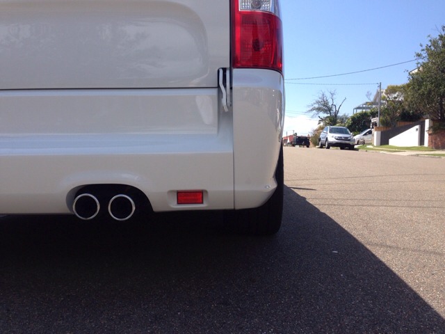

Here's mine. Just got done so needs to settle in. Xyz coilovers front Front drilled and spaced for camber Rear bilstein shocks Custom reset leafs All done by heasman steering Feels like a different car, so much rear grip, so much firmer but not to harsh. Camber is loud on the road though and they replaced rear spacers with solid steel blocks so tyre noise transfers through a little bit more from the rear also. But it's worth it, end result is unreal. Photos are not too good, just took on iPhone Sent from my iPhone using Tapatalk

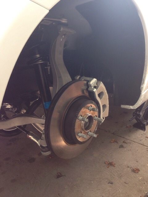

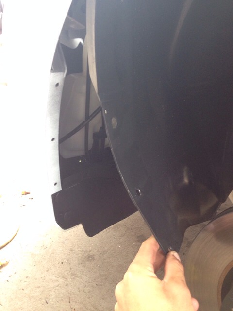

UPDATE Ok so got my car back from Heasman suspension and steering last night. They installed my xyz coilovers Custom built bilstein shocks for the rear With solid steel spacers Custom reset the leafs Drilled and spaces the front for camber Aligned everything Feels like a different car, as soon as I got in everything felt so much sharper. I thought the handling was good out of the showroom but now think it felt like a boat haha. The only issue now is the xyz's are having trouble keeping up with the rear end setup! For all those complaining about grip look at your suspension setup! Might have to upgrade to some front bilstein coilovers in the future. In saying that that's purely on track, for street use it's all fine. So for now absolutely stoked with the difference. Here's some picks of the car getting set up at heasmans. I'll get some good photos up as soon as there is a break in the weather. Sent from my iPhone using Tapatalk

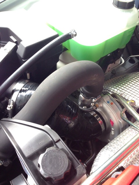

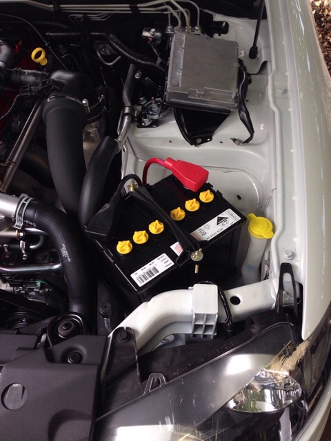

Wheels on! And PW batt relo and 4in inkate on! Fitment wasn't great around the stock intercooler piping. I don't know if the mk2 cooler piping is different but could only just squeeze it in. Cooler will be upgraded soon though As you can see in last pic, very squishy behind that cooler pipe! Then blocked up that bov to get some dose happening I must say it feels like a completely different car now, holds boost through changes so much better and feels as though it's pulling harder, not to mention that insane intake suck noise and that tutututu haha
