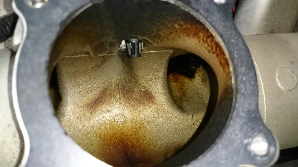

  3. How much oil do you empty out of your can and how often f-wolf? Cause it should be pretty minimal out of the breather, alot could indicate you have serious blow by(a little is normal) or your pcv is passing under positive pressure. As arronm said pcv to manifold seems to be far more of a problem on daily driven vehicles. If you haven't taken your throttle body off do it and have a gander, as quite a bit seems to enter via pcv under vacuum which is "after" or "below" the throttle body, However you want to put it.. Sent from my C6903 using Tapatalk
  4. Yeah well baffled cans are important I imagine, something needs to separate the liquids from the vapour. Apparently short trips compound sludge problems as oil needs to get to 221 degrees to vaporise contaminates, which takes around 20mins. Add to this ford's 15k service intervals and you got yourself sludge. Ask my dead turbo about it...screen blocked and banjo full of sludge...thanks ford. I think arronm's setup is ideal and will keep 95% of sh*t out of the inlet whilst remaining emissions legal. Any idea what it cost mate? Been looking at the areoflow cans on fleebay. Baffled, $119. Sent from my C6903 using Tapatalk
  5. Hey guys, I was doing some servicing on the T the other day and removed the throttle body to clean it and found this: Above the throttle plate,coldside piping is clean. intake,compressor,hotside and I'm guessing to an extent the cooler, has a little oil. So I guess pcv valve is holding fairly well under positive pressure. So as the intake manifold and underside of throttle plate are filthy I can only assume this is all coming in via pcv under vacuum. As a daily driver the manifold is in vacuum quite a bit...otherwise known as Brisbane traffic. So my questions are is this a normal amount for a 96k km vehicle(g6et) and is anybody running a catch can from pcv to manifold with the check on the outlet of the can and with what results? Or maybe a double can setup? I see most single cans are on breather to intake which makes sense if your in the boost alot,like a track car would be, or you have tons of blow by on an N/A pos . I'm thinking double baffled cans to stay emissions legal and keep the oil out of the inlet entirely. If this is normal which I suspect it is in higher k engines then why the feck did ford not just fit a freaking stupid little can you could empty at service intervals? That's a rhetorical. Question btw. Also I'd recommend checking the pcv at regular intervals and cleaning/ replacing as required. It's a check valve in a boosted application(has a spring in N/A applications I think)and mine was passing a little just under the pressure of my lungs let alone boost pressure.I was not able to make it pass after cleaning it.(don't suck through it after drowning it in carb cleaner like I did, wasted half a stubbie rinsing that sh*t out...) It's a potential boost leak and will also result in positive crank case pressure blowing crap out the breather and back into your turbo. End rant. Sent from my C6903 using Tapatalk
