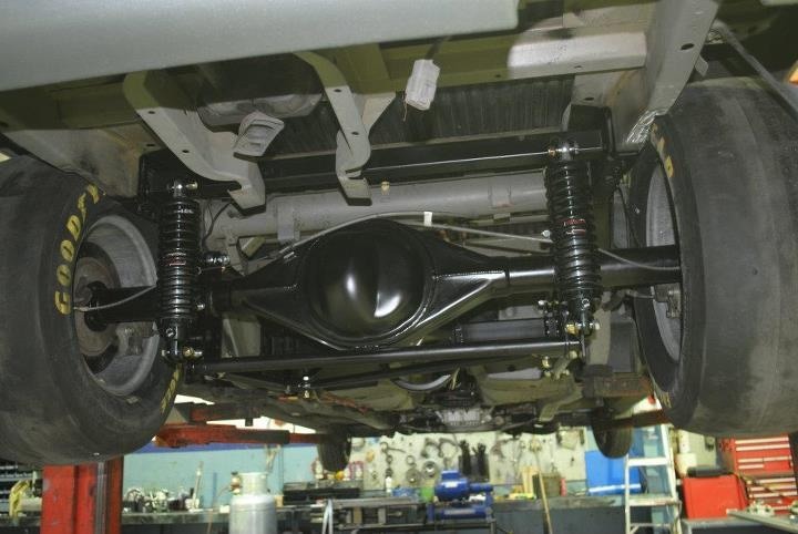

This is my McDonald bros setup in ute. You have to do away with subframe and fuel tank in sedan. -

So it's been a while, things have been slow but slowly but surely getting there having a big change in plans now. I will be getting the car back from McDonald bros racing next weekend, ended up going full race 4 link setup, shortened strange 9" diff, 31 spline moser billet axles, Full spool and also got it mini-tubbed while it was there. Going to sell the c9 that's in it now and go with a Neil chance powerglide and converter from the states. Still unsure on engine may replace it with a 3.7 destroked motor revving to 9,000rpm due to mine only having standard diameter arp head studs. Really need 14mm. The fuel cell is sitting here waiting for the car to make it back so I can't start work on it. 1/2 inch lines throughout, process west fuel rail with a turbo smart fpr2000 regulator and I'd,2000cc injectors, also have (x2) 044 bosch pumps and an 909 bosch pump as a pre pump to a 2.5 ltr surge tank. I have photos of the exhaust manifold I will post shortly. Very impressive design and perfect flow design. Thanks again Leigh

The full 4link setup made for ba. Remove tank etc. the 4link is getting made up as we speak. And il arrange a 9 inch soon to go in. Hopeing to have it don't in next 2 weeks. It's not rubbed yet stainonigger. It's deceiving that photo. The wheels actually stick out of the guards and inch or so. That's the reason I even considered shortening diff

Ok. So it's been years since I last posted on this forum. The old ute has been gathering dust for quiet some time now and I've finally got the bug back and the goal is to take down the ute record. I've recently just purchased new plazmaman plenum, McDonald bros racing 4 link rear end setup. Currently being made. Also brought some brand new Convo pro wheels and new front runners and slicks. Now getting them home and the offset is a bit off. Unsure whether to shorten standard diff or go for a 9 inch. I've also recently put 90/10 front coil over shocks in. Future mods are 4 inch dump. Possibly new turbo /manifold combo. 4 inch intake. Fuel cell and new surge tank as the 4 link goes where the fuel tank sits and will need to modify exhaust to fit around new rear end. Then a retune. Will post some progress pictures soon
