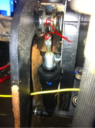

Problem Solvered everybody..!!!! Big thanks to Luke for the help and use of his TIG. Ended up using 3 x 1/2" washers. Tacking them together to make the overall thickness match the old plastic piece. Then notching out a slot in the washers and welding in the pushrod of the Mc.... Works a treat and no doubt stronger then ever. Thanks for all the input fellas..saved me hundreds !!$$!!
Yeah I've dealt with the thurple before... All I can sense is jealousy
Hahaha
In duncraig bud, but I got wheels so I can get anywhere if your willing to help I'd definitely fix you up $$
Sweet cheers. I'll have to hunt a TiG welder... Or maybe take the whole thing to machinist willing to do a cashy $-) I thought TiG welders could only weld light metals like aluminium
I was contemplating this !! Seems a little dodgy but if I could do it right, would turn out better then original. And cheaper too! Any tips? I think I'll give it a crack!! Haha Steve my car hasn't moved from my driveway in like 3 weeks...
How much is a master cylinder bud? And whered you get yours from?
Yeah that would make sense, heavy duty clutch fitted bout 4 months ago. Thanks guys I'll start hunting a new master cylinder then.
Cheers guys, have you seen it happen before
So I've snapped a piece of plastic that connects the clutch pedal to the hydraulic arm that gets squeezed in when you push the clutch in... Car is BA 5spd manual This is the broken part This is where it should be- joining the pedal to the hydraulic chamber thingy.. Wondering if anybody has ever had this happen, if so how on earth do you fix it..? Any information greatly appreciated!
