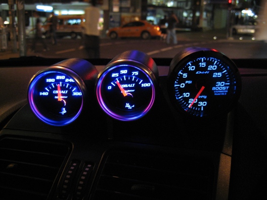

They fit right in. They are 52mm. They look great. Love the look of the defi and they were less then the Cobalts to import.

Nope they just hook right in They look great and the colours suit the car really well and at night they blue dims to almost identical to the dash

It was cheaper then the Cobalt boost gauge to import and I also really liked the look of it. They make a nice group together I think.
About to go looking for the loose wire (hope its a loose wire that is easy to find)!!!!! Dont need to know about temp or pressure as found a post about it. But one last question, in the power source (Cig Lighter) is there a constant near it. I got the ignition and the lights but is there a constant power, one that's even powered when the car is off, or where would the closest one be??? Just for you all thought id add a pic :D
Got mine in Took a while getting them in and had to modify the pod but got the in the end Still setting them up. Dont have the off power sequence going on the Defi, probably wont bother with it though. Also got a loose wire somewhere But they do look nice.
