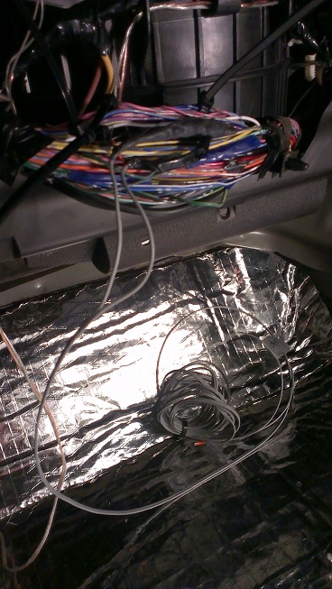

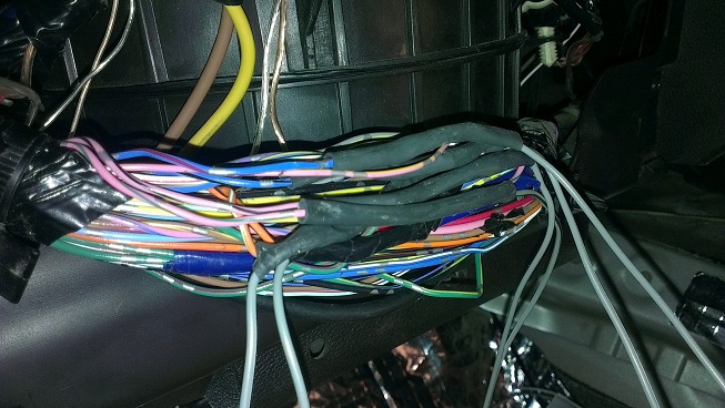

Panda Eyes flame magnet Gold Donating Members 5,674 Member For: 16y 11m 14d Gender: Male Location: adelaide hills- 'race air' central Posted 17/08/12 02:02 AM Author Share Posted 17/08/12 02:02 AM progress over the last couple days...head lining was a bit saggy and crappy, due to being removed and reinstalled by the last owner...half the foam stayed on the roof, half with the lining, so scraped most of that off...will have to replace the headlining, so will do it black, and all the pillars too. a little sound proofing first though...now time for some wiring. I need to run all the wiring I will need to go from front to back, so started with all the high level signals from the icc and going to the sound processor, which will be in the boot... these are behind the glove box.... mainly. what isnt behind the glove box, is the front driver side speaker wires... so out with the icc for a looksy. nup, not there.I looked, and looked and looked, but could not see where they run to the drivers door. the molex plug is non accessible, without taking the fuse box and god knows what else out, so that wasnt an option.so the only way I could see to get around it is to take the signal from in the door itself, and route it back into the cabin.I ran a second wire trace through the door and into the cabin, to run the high level signal wires, plus the new speaker wires from the amplifier...then attached the front and rear passenger, and rear driver wires to signal wires running to the boot...this is how I twisted the pairs...now time to go out and run some more wires... 1 Link to comment https://www.fordxr6turbo.com/forum/topic/80955-starting-new-stereo-build/page/8/#findComment-1280506 Share on other sites More sharing options...
