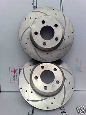

GR8XR6 ANGEL EYES Legacy Donating Member 1,683 Member For: 18y 2m 6d Gender: Male Location: SE Suburbs, Melbourne Posted 29/04/09 03:59 AM Posted 29/04/09 03:59 AM Brand new disc rotors to suit BA-BF XR8, XR6 AND XR6 TURBO Ford FalconRotor Width is 298mm,Seen these on ebay. Has anyone used these? Are they any good? If not what would you recommend to upgrade to from standard brakes?
ZAP No boost, no bottle, just my foot on the throttle! Legacy Donating Member 7,935 Member For: 22y 7m 13d Gender: Male Location: Sydney Posted 29/04/09 04:34 AM Posted 29/04/09 04:34 AM I would steer clear of anything non branded to do with brakes.The best choice for stock replacements ar the DBA4000 series.Drilled rotors also tend to crack.

our06t Mmmmm......BOOST Member 3,135 Member For: 19y 5m Gender: Male Location: central coast Posted 29/04/09 05:00 AM Posted 29/04/09 05:00 AM I have had a good run with rda dimpled and slotted gold series discs done around 15k most of it fairly hard on the brakes with no worries , being dimpled rather than x-drilled it avoids the risk of cracking between the drill holes

nelsonian101 Legacy Donating Member 961 Member For: 18y 3m 2d Gender: Male Location: Sydney Posted 29/04/09 07:27 AM Posted 29/04/09 07:27 AM I would steer clear of anything non branded to do with brakes.The best choice for stock replacements ar the DBA4000 series.Drilled rotors also tend to crack.2nd that. Steel quality is not up too par with the brand named items and if they are drilled too....I can see them heat stress/fatigue cracking with any serious useage.
