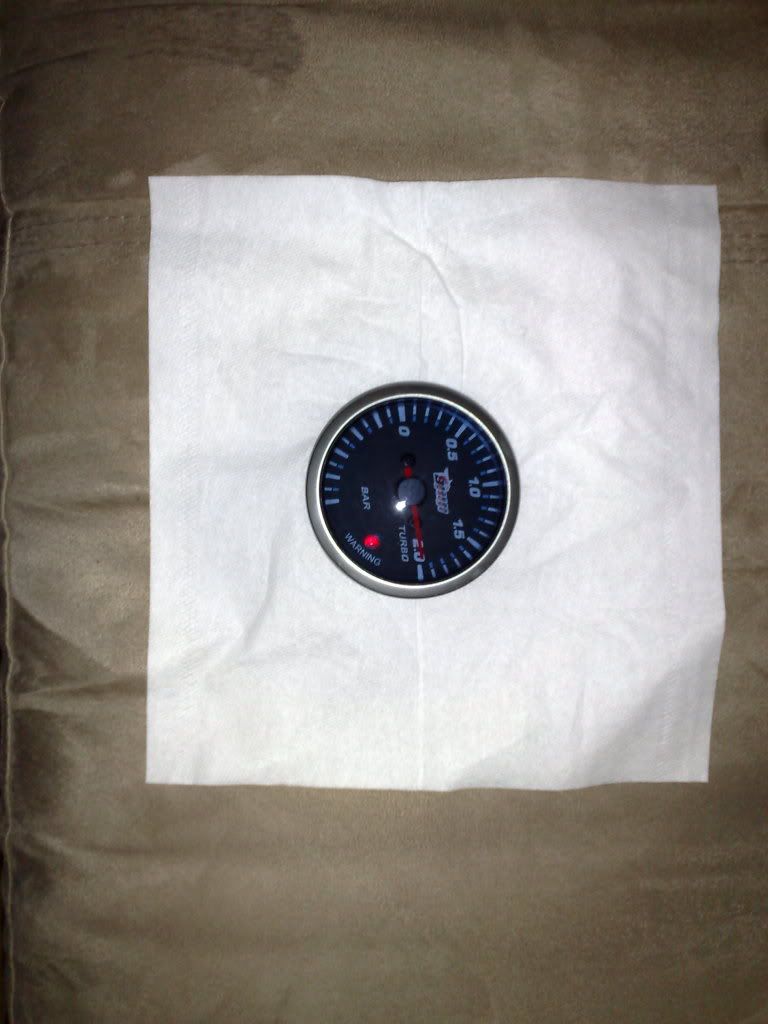

PHANTMXR6 It's not a MKI! Member 1,742 Member For: 16y 11m 29d Gender: Male Location: Earth Posted 16/12/08 11:51 AM Author Share Posted 16/12/08 11:51 AM Haha. Nice one Dags.I was wondering how long it would take someone.When I laid the first coat of 'glass I had just watched the first 2 episodes of Star Wars.I thought it looked like the Imperial trooper helmets. Any who. Here's the boost gauge I'll be running.http://i702.photobucket.com/albums/ww30/PH...16122008062.jpgdoes this sit ontop of the icc?Sure does. Link to comment https://www.fordxr6turbo.com/forum/topic/52547-fg-dash-gauge-pod/page/3/#findComment-787527 Share on other sites More sharing options...

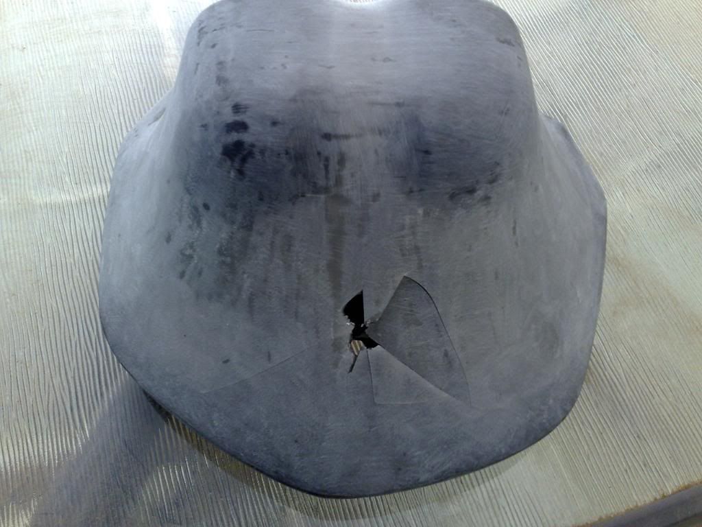

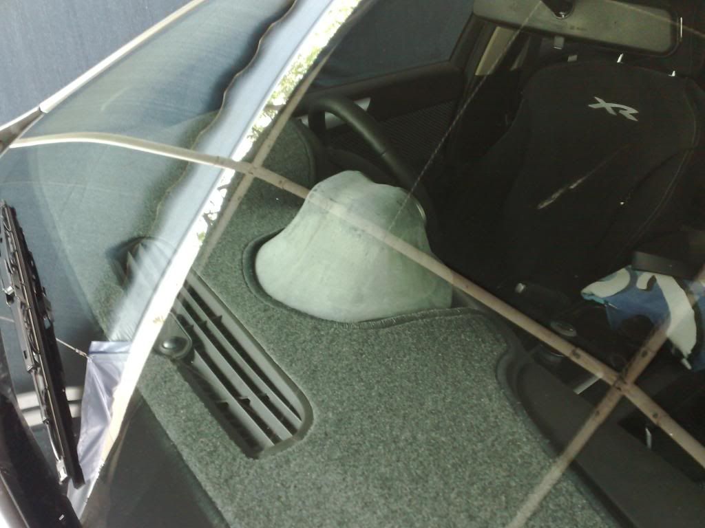

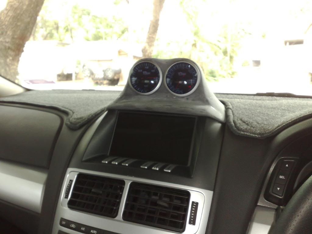

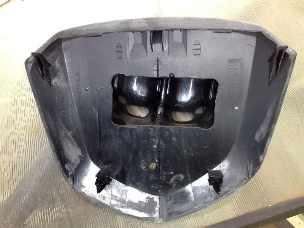

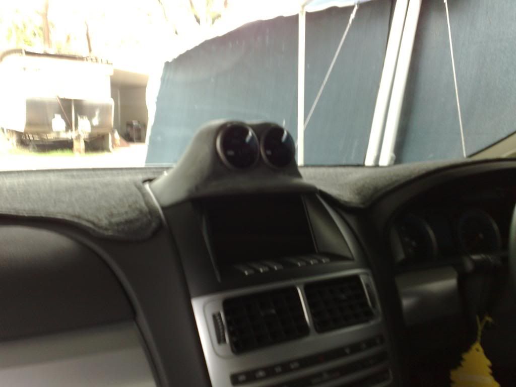

PHANTMXR6 It's not a MKI! Member 1,742 Member For: 16y 11m 29d Gender: Male Location: Earth Posted 17/12/08 07:03 AM Author Share Posted 17/12/08 07:03 AM Well I got the pod finished today, ready for paint and disaster struck again.http://i702.photobucket.com/albums/ww30/PH...17122008068.jpgI drilled this hole to fill the cavity with expanding foam for a bit more strength.Unfortunately the drill went a bit far.http://i702.photobucket.com/albums/ww30/PH...17122008069.jpgBugger!!! I needed to get it to the panel beaters today for paint as the painter is going on holidays tomorrow.Unfortunately I don't have enough time to get this finished before I go on holidays and then back to work, so it'll bemid January before it's finished.Luckily I got some pics of it in the car and with the gauges fitted before I busted it.http://i702.photobucket.com/albums/ww30/PH...17122008064.jpghttp://i702.photobucket.com/albums/ww30/PH...17122008067.jpghttp://i702.photobucket.com/albums/ww30/PH...17122008065.jpghttp://i702.photobucket.com/albums/ww30/PH...17122008066.jpgIt doesn't actually sit that high either.I reckon it wouldn't be much higher than the bulge bonnet on the XR8 if at all. Link to comment https://www.fordxr6turbo.com/forum/topic/52547-fg-dash-gauge-pod/page/3/#findComment-787891 Share on other sites More sharing options...

PHANTMXR6 It's not a MKI! Member 1,742 Member For: 16y 11m 29d Gender: Male Location: Earth Posted 12/01/09 10:48 AM Author Share Posted 12/01/09 10:48 AM There was no mould. All free hand.I used a factory top dash panel and a cheap twin gauge holder off ebay. Screwed the gauge holder to the panel and then covered it in a stocking to get the nice flowing lines.Then came the resin. I didn't use any mat due to my laziness in not wanting to clean it up afterwards, and the resin seemed to work well.I finished it yesterday but it will be with my panel beater for a few weeks while I return to work.As with my head unit surround. They both turned out quite well I reckon.Can't wait to get the painted products in the car.I've done a few fibreglass projects in the past. Mainly car audio sub boxes and trim panels. Bit of a hobby really, and no-one else to do it where I live.These two will be one offs, and if I make another gauge holder I'd be looking at trying to get three smaller gauges up there.Time will tell. Link to comment https://www.fordxr6turbo.com/forum/topic/52547-fg-dash-gauge-pod/page/3/#findComment-801408 Share on other sites More sharing options...
