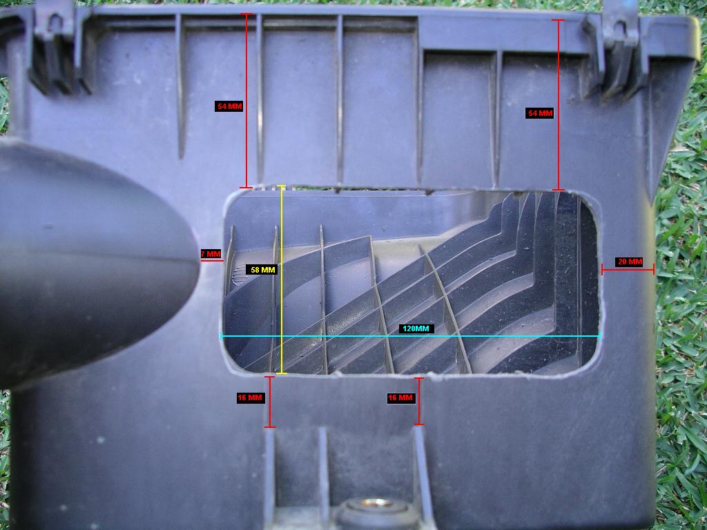

MaTTe Member 143 Member For: 17y 11m 3d Location: Perth Posted 04/12/08 09:15 AM Posted 04/12/08 09:15 AM for the effort vs. need vs. want I reckon it'd be worth cutting out the hole that the snorkel needs and using that in the short term. You'll get some warmer air filtering in aswell as the air from under the headlight. It'll cost you nothing, and you'll gain some more air into the intake.There should be a template of where to make the cuts somewhere here on the forums.
seventytwo Still have a turbo, it's just on a diesel. Legacy Donating Member 5,368 Member For: 21y 2m 27d Gender: Male Location: The 8th Dimension Posted 04/12/08 09:22 AM Posted 04/12/08 09:22 AM Try here
