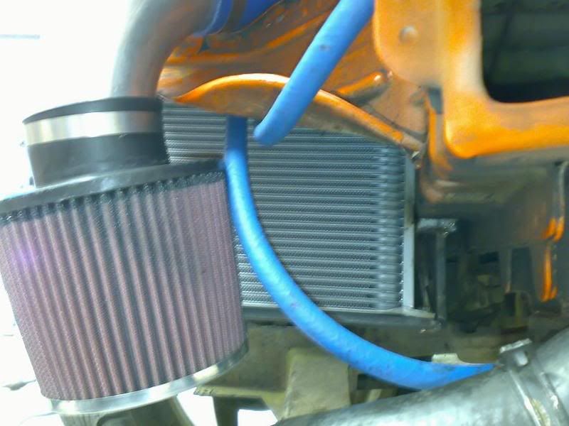

I have just done this exact setup.
The hardest bit is mounting the cooler as there isnt much to go off and my cooler is a top of the line earls one it is heavier than the pwr type ones.

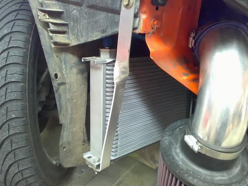

I decided to make a bracket from 30x5mm steel strap that the cooler actually sits on so it is completely supported from underneath,not hanging from the top.
I then mig welded the bracket to the chassis rail,its about as tough as a trans cooler mount can get.To finish the mount I ran a strap from the outside corner up to a bolt on the front end,the cooler is now so stiff nothing will move it and it definately wont rattle .

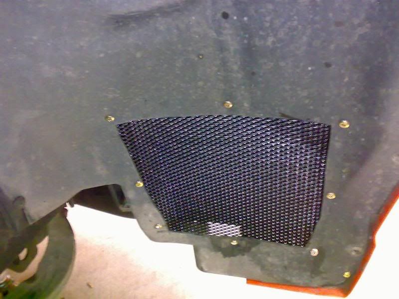

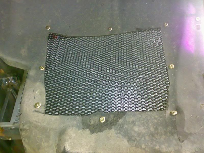

I then marked out the size of the hole I wanted behind the cooler and cut it out with tinsnips,I had an air hacksaw but it just melted the plastic and stopped cutting,tinsnips worked well.
Once I had removed the waste section I used it as a template to cut my expanded metal sheet cutting it about 20mm bigger all around so I had something to screw into.

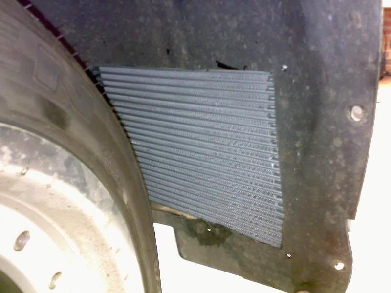

I made sure that I had the angle of the louvres correct so that from the direction the wheel travels you cant see in,its like a solid sheet,but from underneath,the opposite way the wheels spins its a clear view through the sheet.
This way my cooler wont cop any hits from debris flying off the wheel but it allows the cooler to breathe.
I then screwed it on with self tappers straight into the expanded metal sheet,it actually holds really well.

the bracket welded to the chassis can be seen here
side strap
the hole cut
view from the top,cant see in ;)
view from the bottom,full flow
