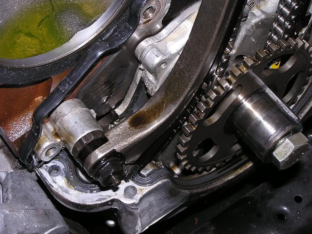

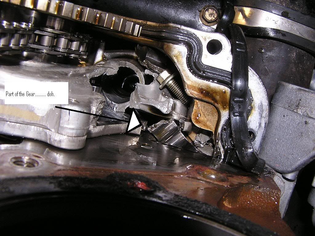

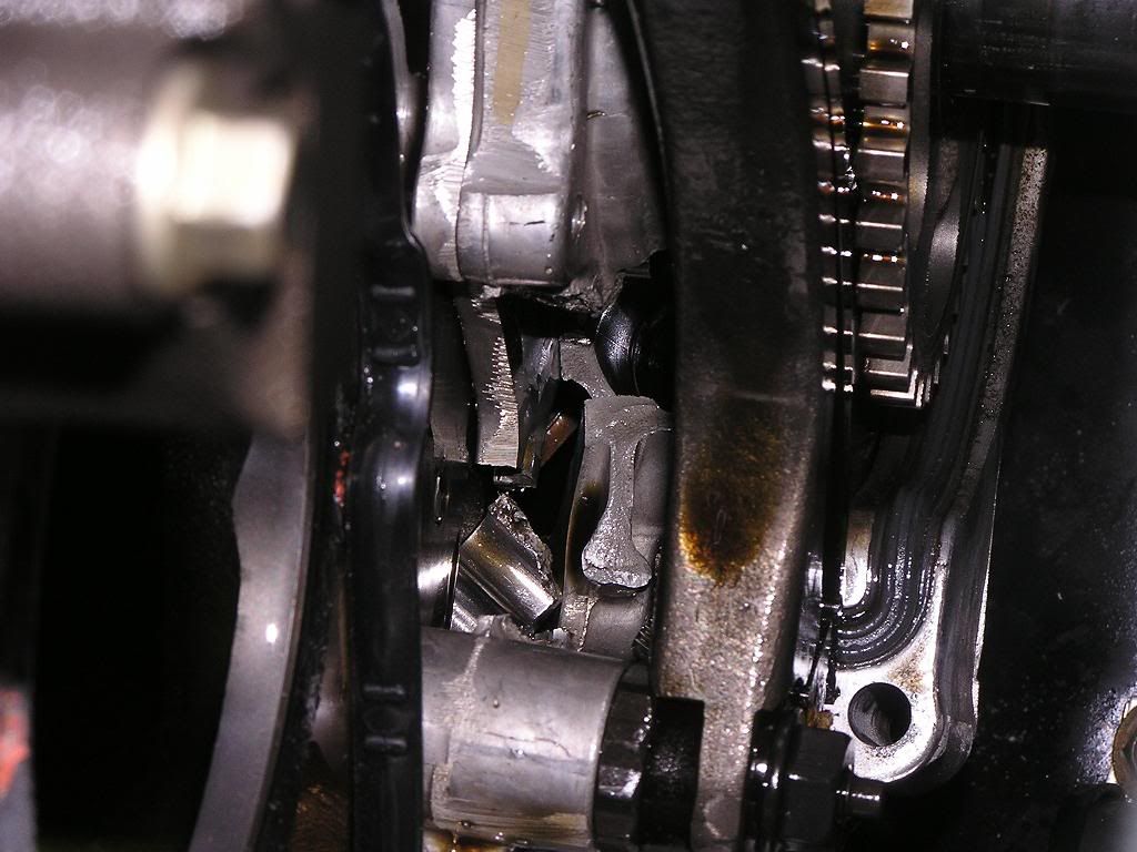

F6 UTE - Track Bound EVO III - Member 3,367 Member For: 20y 5m 12d Gender: Male Location: Strapped in and holding on Posted 07/07/06 04:15 AM Author Share Posted 07/07/06 04:15 AM Got some pix of the exit wounds.Looks like the gear has combusted and exit stage left.........Bout to drop the sump.. looks fairly easy.. Then leave the rest ( removal & timing gear ) for my mate to do..Hoping she's back to her old self tonight.. hopefully.. Link to comment https://www.fordxr6turbo.com/forum/topic/26592-f6-ute-broken/page/6/#findComment-403300 Share on other sites More sharing options...

F6 UTE - Track Bound EVO III - Member 3,367 Member For: 20y 5m 12d Gender: Male Location: Strapped in and holding on Posted 07/07/06 05:32 AM Author Share Posted 07/07/06 05:32 AM It could have been disasterous. The timing chain guide was flapping in the breeze, as it's support was smashed to bits. If the chain had of come loose, or skipped a few teeth ............................ bits of valve into pistons.. would have been rather exxy.. Link to comment https://www.fordxr6turbo.com/forum/topic/26592-f6-ute-broken/page/6/#findComment-403323 Share on other sites More sharing options...

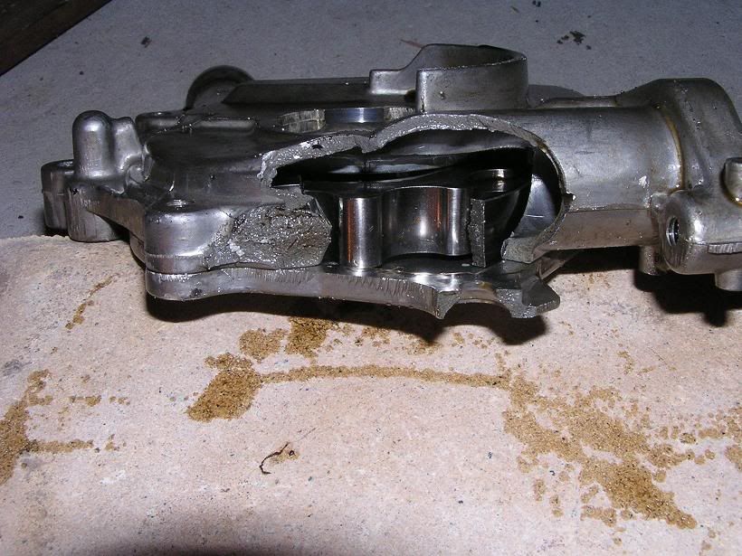

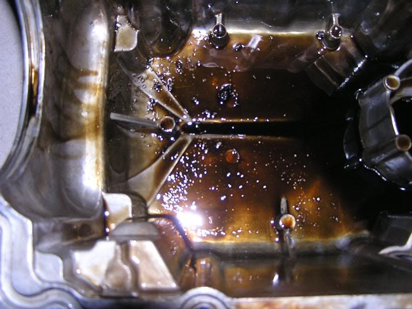

F6 UTE - Track Bound EVO III - Member 3,367 Member For: 20y 5m 12d Gender: Male Location: Strapped in and holding on Posted 08/07/06 04:29 AM Author Share Posted 08/07/06 04:29 AM Finally got the sump off...... dropped the crossmember and front suspension arms what a fugging plick of a job... Damage -And the bits left in the sump -This section was sitting in the oil pickup.............The gears took out the Timing chain tensioner guide on the way out .. We went to put it back in and realised.. New one of those comin Monday.. Link to comment https://www.fordxr6turbo.com/forum/topic/26592-f6-ute-broken/page/6/#findComment-403777 Share on other sites More sharing options...
