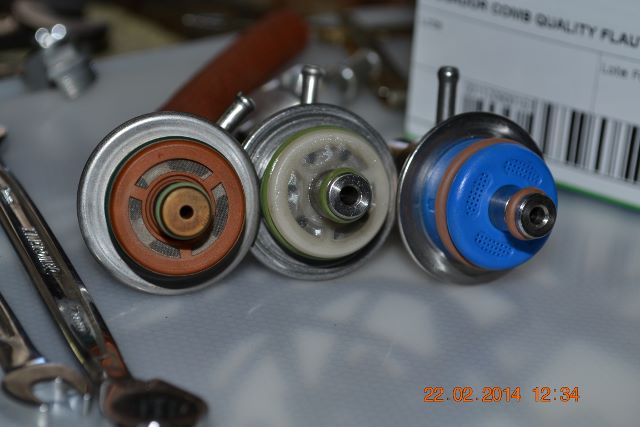

I thought I was done with this but here goes.. SO improved flow and decreased pressure at low rpm ?? yeah ?? and u say that has NO bearing on overall pressure and flow of the 044 ?? so decreasing FP and being able to lower the scaling of a restrictively high base FP has ZERO impact overall with flow u reckon ?? AND thus the lower the FP as a base rate at low rpm therefore lowers the rate at max rpm after a rising rate increase true ??? so lower base rate add 20psi from boost and u say there is no difference from a stock reg ?? lol next time u have a piss try pissing thru a straw and then change to a toilet roll and tell me this has NO impact on the pressure out the other side... :/ -

My apologies for being vague.. im being vague because as said I dont actually know what was done 100% .. My friend did it at his mechanics shop on the bench while I was there and I dont know what the components are in a cradle.. All my previous fuel systems have been external and this is the first car iv had that uses a cradle and intank setup.. -

Cheers mate for the advice.. im pretty sure u had commented or offered knowledge on the thread where I got my inspiration and idea to change reg.. The reg I have used is a drop in blueprinted 4bar reg (centre picture) as per good advice from a few other threads here.. I didnt take a comparison photo cause I was in a hurry but this photo is from another thread showing the diff between the size of the return hole which is a major restricting point in the system as all the system has to return thru the factory pinhole.. doing it again id do the drop in adjustable reg (right picture) that fits into the factory spot so there is a touch more adjust-ability or bung up the factory reg and plum in an after market into the 5/16 line.. -

No I cant remember what it was exactly, we dismantled it on the bench and opened up a few things.. it was somewhere on here I read to do it as a small mod whilst cradle is out.. again its not what im claiming is the deal sealer.. if it has a small effect then it cant hurt to try it.. its mostly about lowering the base fuel pressure with the reg mod and thus greatly improving flow around the surge and to the injectors.. cant argue that pumps operate at a higher flow rate with a decrease in fuel pressure all round which is what I have achieved.. Will see anyways just about to book it in and see how I go with what I have..
