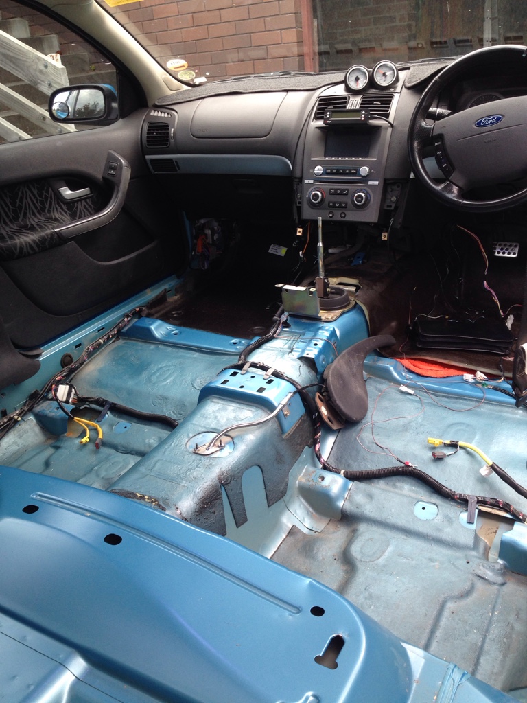

haha none of that. I kept finding stuff in the car from previous owners. and after 200k the carpet wasn't looking the best around the seats, and I just got carried away. Found that the insulation under the drivers feet was soaking wet for some reason, so aired that out also. And enabled me to re do the wiring for the reversing camera to come up the middle instead of the sides.
Took the interior apart and put back together. Gained $20 in coins! And cleaned all the hard to get to places
