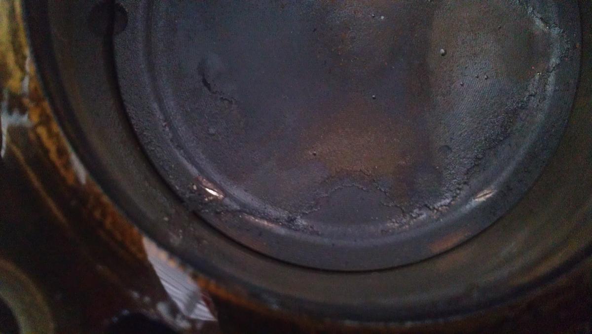

Thanks lads. Yea dave knows his stuff and the motor failing was no way his fault only mine... I had a drift fuel filter and didnt realise the element had actually come loose in the filter and was starving the motor. But the bent rod didnt happen straight away so I think it gradually got worse until the piston was hitting the crank as can be seen in one of the photos. Yea bomber another fg block in a b series only coz youse got the good internals and the crappy fg looks lol jks jks...Oh and my cousin I building his block atm so I think we'll be looking at a drum of e85 soon as there both built,
Ok so I been a round for a little while but figure its time to introduce myself and show everyone my ute and details on it. It was putting 515rwhp at 20 psi tuned by Dave Sheehy at CPV with a pw 2.3 kit, 4" dump 3 1/2" back exhaust, Standard turbo + ported housing, nizpro re-drilled injetors, aeromotive stealth in tank pump + 044 and jd customs surge tank. Standard internalsadn valve springs. Well after numerous drag meets plus powercruise last year my motor has thrown in the towel... The only way I found out was it started making a ticking noise straight after start up. Details of this can be found in oil pump questions topic in engine topics as this is what I thought it was. But after stripping the engine down with the help of my cousin 45t xr and a mate and his hoist we found that I was running vcr (variable compression ratio lol jks jks) Numer 1 rod was like spaghetti. And now that ive had a closer look at it I think number 6 was close to it aswell but not as bad. So I stripped the engine down just leaving block and rods and pistons and crank together for now. But after having a closer look it would seem that number 3 inake vavles have hit the piston a bit (pics below). After much deliberation I decided to order a fg f6 short motor and with the help of a member on here it turned up today. This was because im in gladstone and 1 I dont have time plus I dont have the knowledge and 2 theres know one in the area that id trust with my mower let alone my ute. Plus the other thing was m aim is 400kw and after reading a few post in the 400 threads there seems to be a fare few people pushing the 400 with standard fg rods and pistons. This is my plan: Fg f6 short with atomic oil pump + atomic hd timing chain and crank gear. And brand new guides and tensioner. Atomic valve springs and water methanol for safety and to help a little bit to push over that 400 mark.

well I found my problem... I reckon I could have still got anohter 100k out of it give or take...lol Now its just decision time...Either fg short motor or try and find someone to build mine on the provisor that the block and crank are ok .
