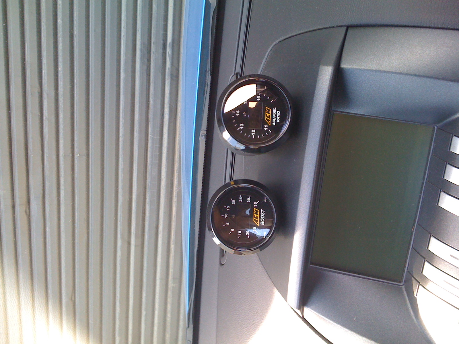

Hi jetfg Mate I got my Pod From a Company called Top End Audio in WA, the guys name was Wally I think from memory and at the time he did 2 and 3 pod. I also got installed AEM gauges (Boost and Air/Fuel Ratio) Piccy Below. I got these from Quantam Racing in Woodridge. Hope this may help.
