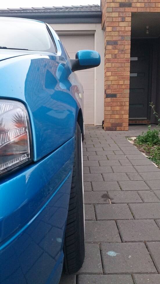

Spyathe Legacy Donating Member 872 Member For: 12y 10m 23d Gender: Male Posted 11/05/14 10:51 AM Posted 11/05/14 10:51 AM (edited) 9.5 +27 on the front is probably the absolute limit unless you're running spacers10.5 +35 on the rear will probably hit things (not 100% though)This is a 9.5 +35 with an 8mm spacer Edited 11/05/14 10:52 AM by Spyathe
Spyathe Legacy Donating Member 872 Member For: 12y 10m 23d Gender: Male Posted 11/05/14 11:09 AM Posted 11/05/14 11:09 AM Edit: I just noticed you have a G6e so you should probably disregard everything I have said lol 1
