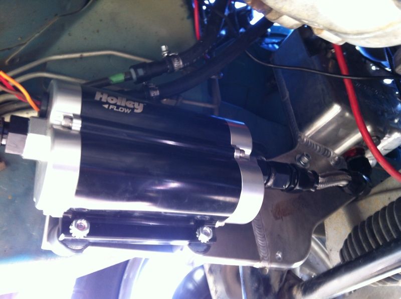

I got one of the 1400hp pump going on mine in the next couple weeks. Will let you know how this goes on the BA when its tuned as im going aftermarket rail, reg and injectors for e85.

I fitted up my 1400hp pump to a plaz surge on the weekend. Also ran the rest of my fuel system which was Aeroflow twin entry rail (only running single entry atm), Turbosmart 1200 reg and all braided -8 fuel line for e85 and 1000cc injectors to go in at the time of tune.
As for noise level I would say its quiter than a single 044, can definatly here it on prime up but when the car is running you really have to listen for it.
4E7F4AB2-A754-40EB-AD85-970E1F556648-984
