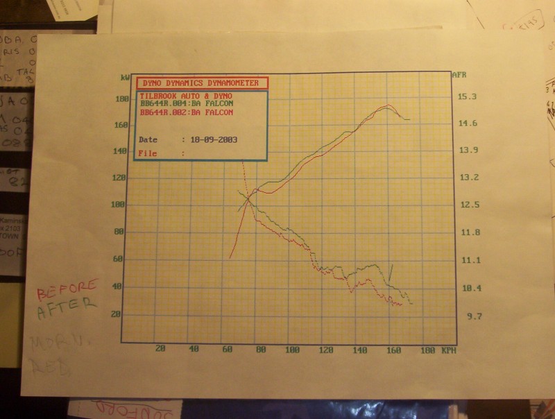

Guest Guests Posted 19/11/03 12:46 AM Posted 19/11/03 12:46 AM Here is the before and after in normal mode not Shootout Mode
Guest Guests Posted 20/11/03 08:47 PM Posted 20/11/03 08:47 PM As you can see more grunt down low,quite noticeable,top end peters out a bit but that is bugger all.No avgas here in hicksville used BP 98, asked why my kws are so low compared to the eastern boys,he said he could give me higher if I want,you can fiddle it up.vik
