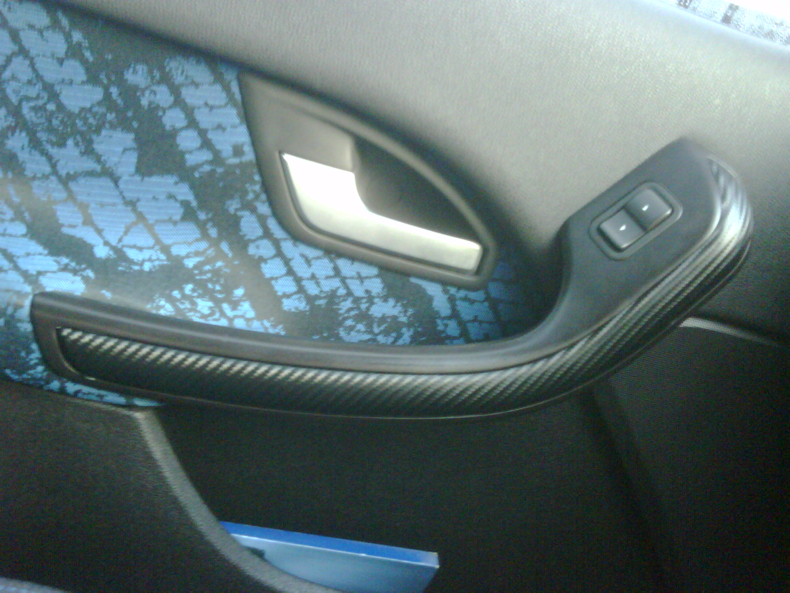

Looks good mate, I've been wanting to try this on my car for a while but was unsure how it would look.
What size sheet did you buy?

got mine from here great service .
3M Di-Noc Carbon Fiber Fibre Vinyl Film Wrap CA-421 .5m - eBay Decals, Decals, Badges, Detailing, Car, Truck Parts, Cars, Bikes, Boats. (end time 10-Oct-10 11:47:55 AEDST)
the 1.2 by.5m I think will be enough to do the door inserts ,gear surround and silver bits along the dash.
they have all different sizes though
finished the other 3 ,think the gear surround will be the biggest challenge but with the right amount of heat it's very workable.
if you do give it a go I wanted a uniform look so it took a little thinking to get the pattern running the same direction on each piece, but you could go random and just put it on anyway it fits
Looks good mate...
Its the same sheet as mine... I payed 100 bucks for 1m x 1m..
The biggest problem I had was getting the aligned ... I gave up when it came to the door inserts lol

nice that's got me motivated to finish the rest of it ,that looks great. :turboboink:
how long you had it on for any problems?
Edited by our06t
#18
Had mine in for about 2 weeks now..
The centre peice cover for the gbox sometimes bubbles only coz I rushed it a little...
You need to make sure you start from the inside out... Lay it over it first, then start from the inside..
Then with the contours, you have to shape it before tucking it under (if that make sense? :turboboink:
I was considering on doing the ICC but it wont fit under the buttons I dont think... What you reckon?

yeh looked at that but think I would need a lot of practice before attacking a job that detailed .
could be done with enough practice though
