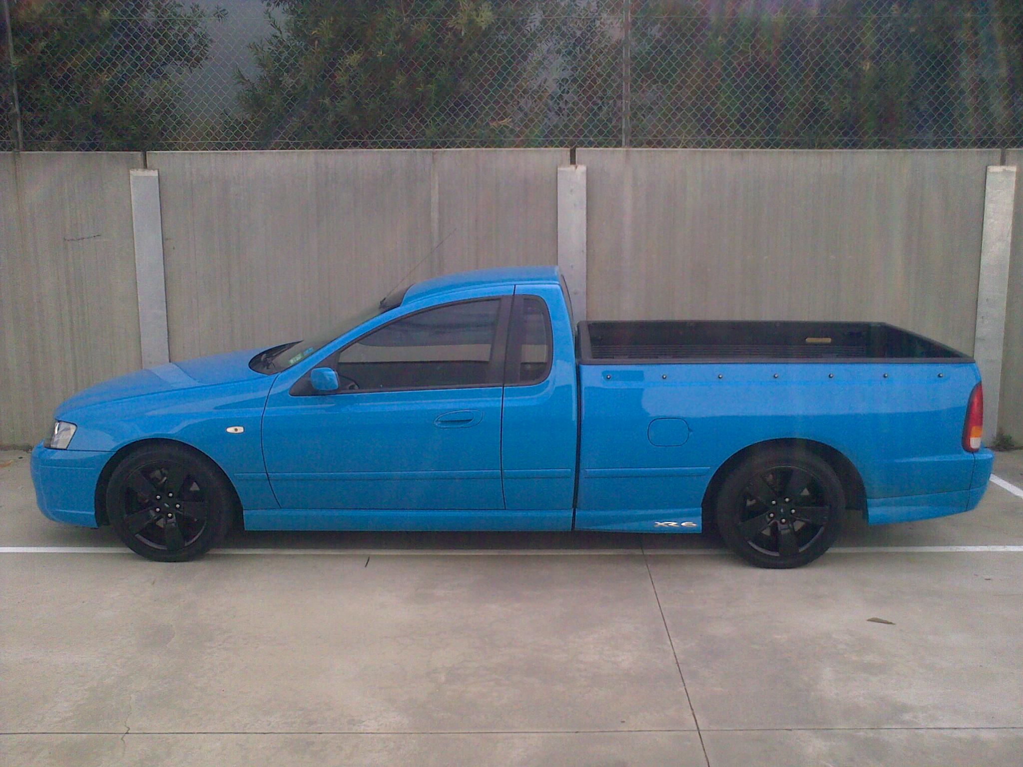

Hi guys,
Just for something different I decided to paint my stock BF rims gloss black.
Here are some pics. Sorry about the crap phone quality.
Just used spray cans. Sanded back, cleaned with thinner, 2 primer coats, 4 coats using gloss black engine enamel and 4 clear coat.
  • 10.5 @ 132MPH

Steve something along the lines of 300-400 would be fine. I done these back in the day too haha
Here was mine on the old ute:

Which grit paper?
I used around 120 (it was a sponge) then to get into the tighter stuff I used a higher grit (medium) sponge folded in half. It’s so much easier than paper.
And I had really dirty wheels. Just go nice and light if using coarse stuff.
I found that if using really fine paper your there for ages trying to clean it out. Primer also sticks a lot better if you take the original finish off.
