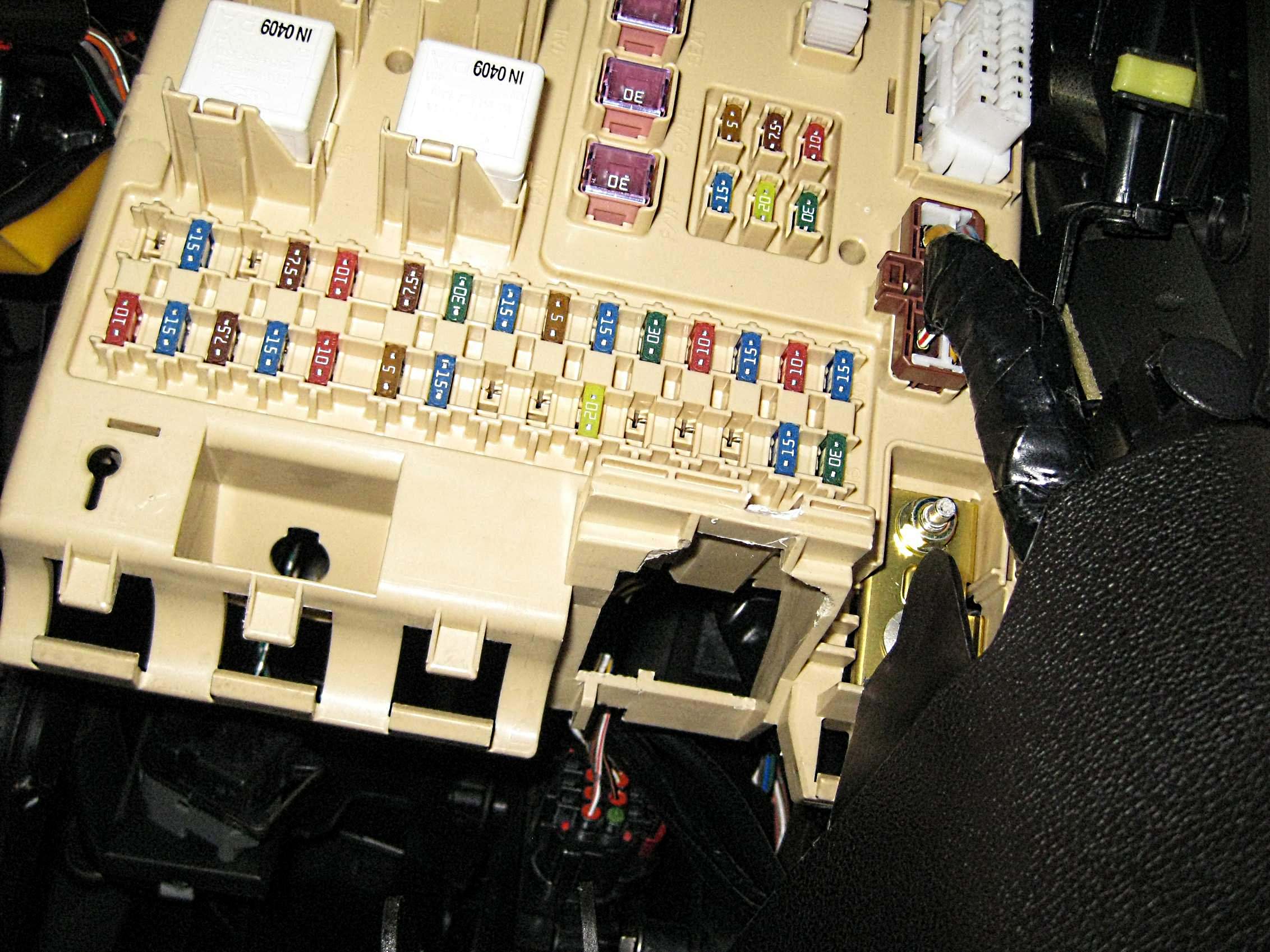

Guys, I have been unable to get the bonnet pull assembly to locate into this fuse panel.It just falls out
What breaks in this assembly? The locating cutout is in the lower right side.

Hi robbiefisher , whats happened is your bonnet cable has jammed and the plastic captive cage on the fuse block has broken.
You will need a new fuse block assembly.

#8
hey mate, they actually redesigned the system about a year ago, so you just need the new bonnet release lever, its located in the fuse block differently so you shouldn't need a new fuse block.
If you go in and see the service guys they should be able to look at it and see that its fine (provided you get an honest worker) then buy a new one and have it fitted on the spot, or take it home and fit it up.
