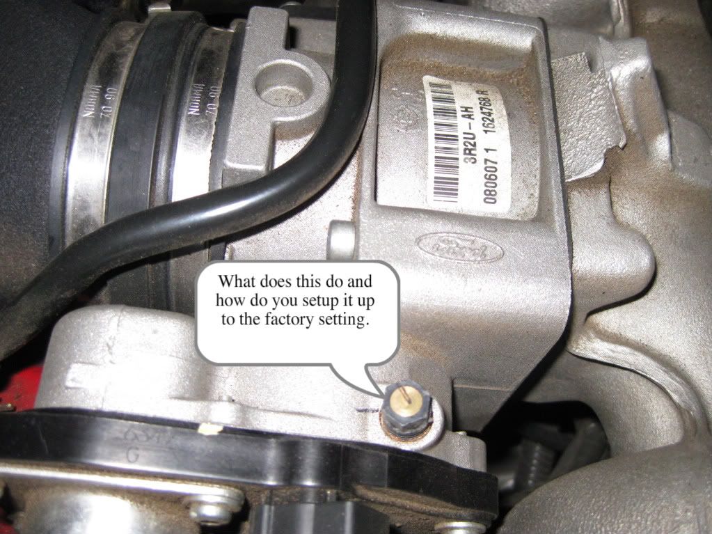

Gee Member 131 Member For: 17y 5m 16d Gender: Male Location: Melbourne Posted 17/01/10 04:55 AM Posted 17/01/10 04:55 AM This adjustment (see below)has fixed my pause on take off and I am wondering what I have adjusted?Can someone please tell me what I have adjusted, how to set it back to a factory setup and what affects this has on my car.This adjustment is found on the throttle body.
BA-XR6T Member 69 Member For: 16y 9m 14d Gender: Male Location: Miranda Posted 27/01/10 12:51 AM Posted 27/01/10 12:51 AM Just had a chat with the CV boys and they tell me it's a throttle stop. Be very careful with this screw as it is plastic and the temperatures it's exposed to in the engine bay makes it brittle and it breaks easily, therefore it is recommended not to adjust it. It stops the engine getting too many revs and overheating.
TURBO4LT Member 1,533 Member For: 23y 1m 14d Gender: Male Location: NSW Posted 27/01/10 08:30 AM Posted 27/01/10 08:30 AM Its not adjustable if you try and turn it you will probably break it.
