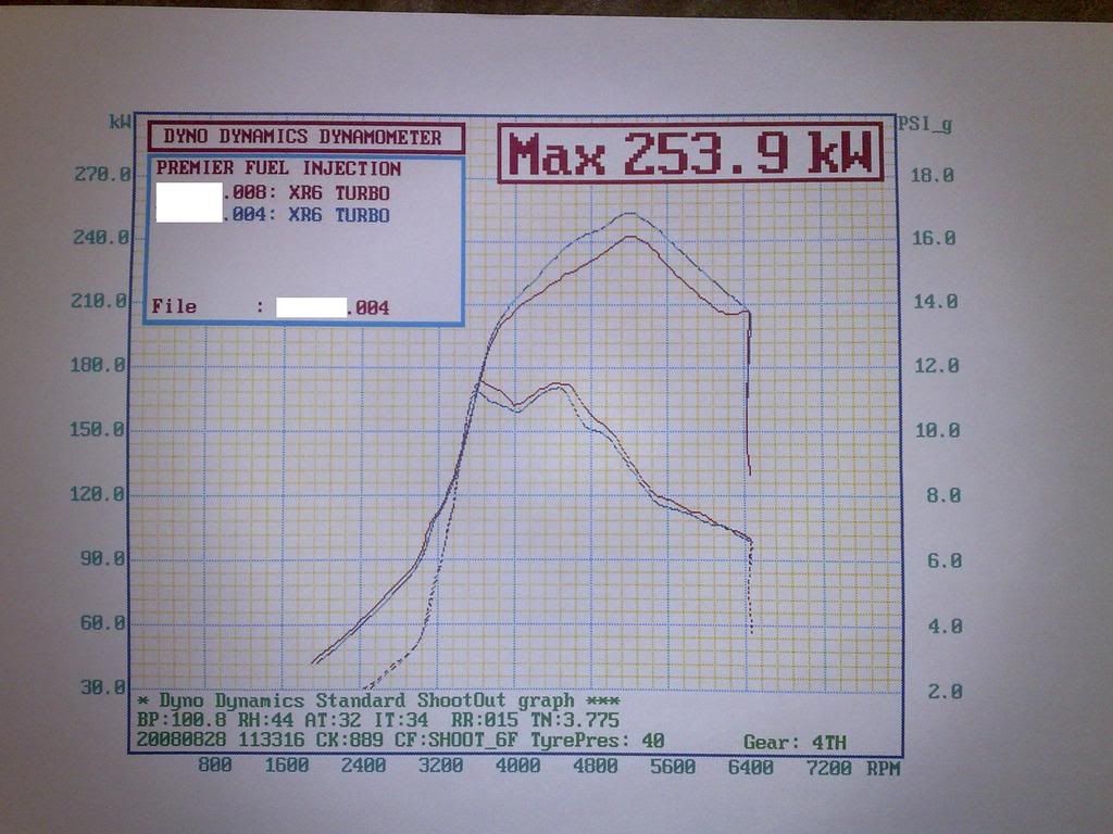

PHANTMXR6 It's not a MKI! Member 1,742 Member For: 16y 10m 18d Gender: Male Location: Earth Posted 16/12/09 12:54 PM Share Posted 16/12/09 12:54 PM The airbox or airfilter changes have not proven consistent results and as such, I would not bother with either. I myself have an xr8 airbox on my fg f6 and am not sure if it made any difference to overall power.EnricoPalazzo, the airbox and snorkel does make a difference to an XR.You have an F6. Different turbo configuration so different results.This is the dyno sheet from my back to back testing with the standard airbox and snorkel and the XR8 snorkel and airbox.The red line is the standard parts, the blue line the larger diameter items.Arkayne, due to your town of residence and the high ambient temperature most of the year, it would be wise to upgrade the pipe if you are increasing boost. Link to comment https://www.fordxr6turbo.com/forum/topic/64377-first-mods-for-fg-xr6-turbo/page/3/#findComment-963770 Share on other sites More sharing options...
Buf-Phoon loitering with intent Lifetime Members 13,318 Member For: 21y 8m 18d Gender: Male Location: Zombie Birdhouse Posted 16/12/09 01:31 PM Share Posted 16/12/09 01:31 PM falls off the cliff pretty hard is that due to fuel ? Link to comment https://www.fordxr6turbo.com/forum/topic/64377-first-mods-for-fg-xr6-turbo/page/3/#findComment-963783 Share on other sites More sharing options...

PHANTMXR6 It's not a MKI! Member 1,742 Member For: 16y 10m 18d Gender: Male Location: Earth Posted 16/12/09 11:40 PM Share Posted 16/12/09 11:40 PM falls off the cliff pretty hard is that due to fuel ?Yep. Hard cut. Not a nice sound either. Link to comment https://www.fordxr6turbo.com/forum/topic/64377-first-mods-for-fg-xr6-turbo/page/3/#findComment-963845 Share on other sites More sharing options...
