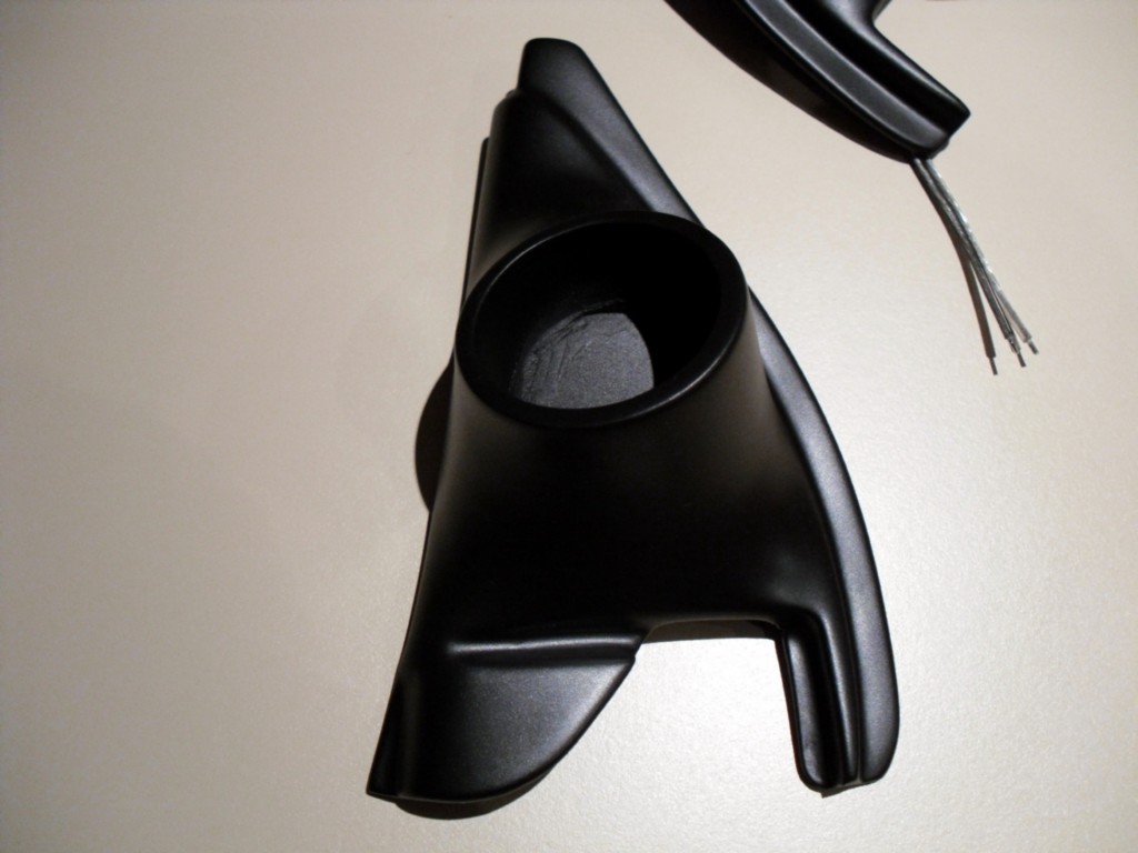

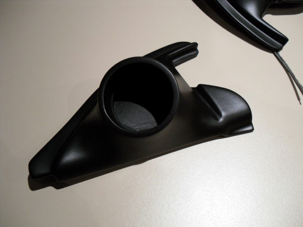

sh*t of a thing this poly. I am making a pair of custom tweeter pods and need to bond some PVC, to the door mirror garnishes.
3M make a glue but you need to buy their applicator and nozzles, nearly $150 for something I will never use again.
#7
I found a glue that does the job and is cheap. Loctite All Plastics Glue, works the treat.
Two part formula, has an activator and some snazzy super glue. You can also prime and lightly coat the
areas that will need filling then, your bog or epoxy will stick to the adhesive that's been laid down, it will
be a good strong bond.

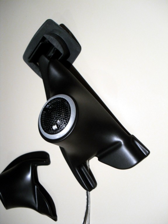

Finally finished the tweeter pods, I think they look good? I will post more pics and start a new thread when the install is finished, I am using Rainbow CS265 Vanadiums
for the front stage.
