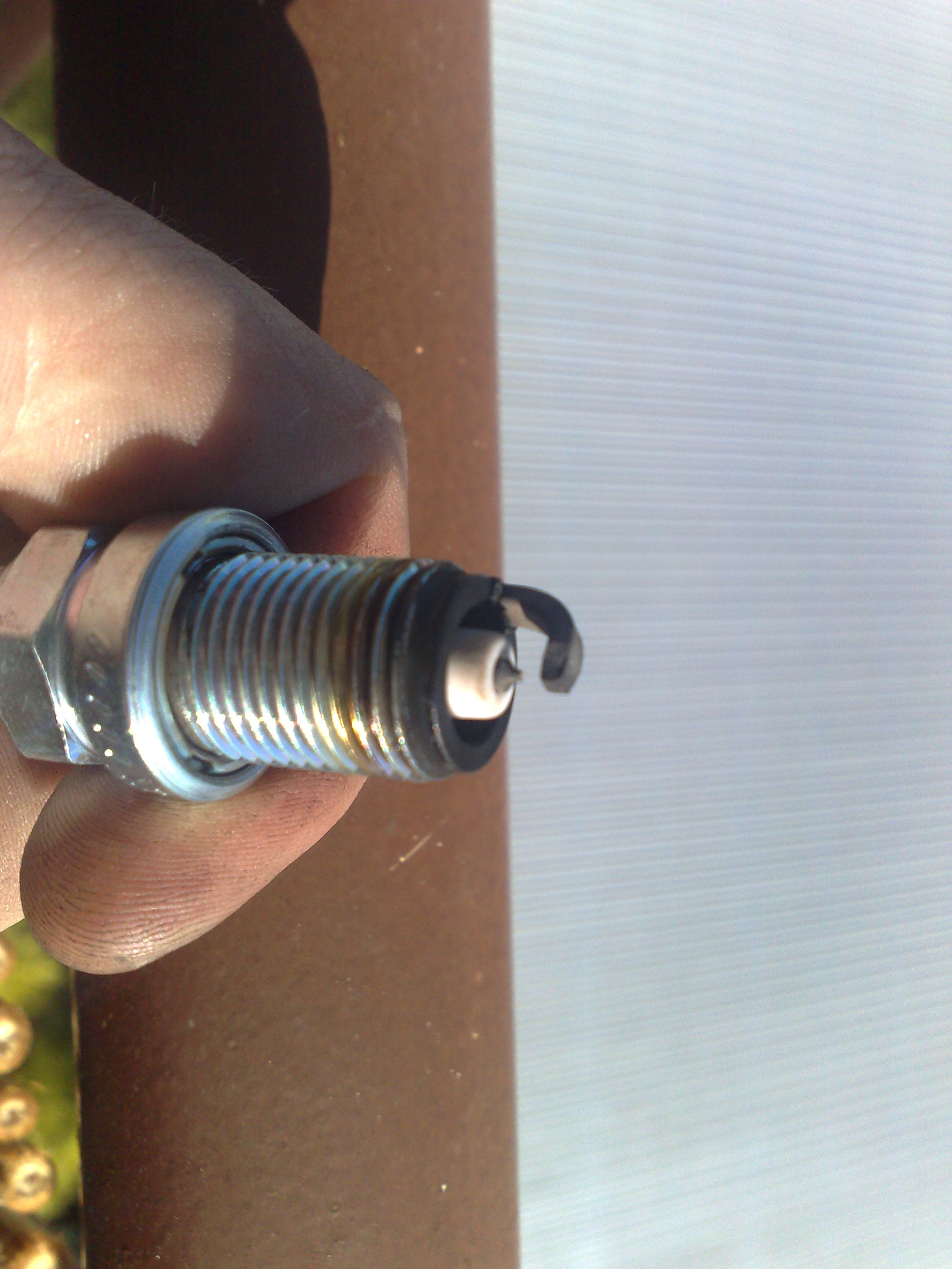

norrs Legacy Donating Member 448 Member For: 19y 2m 14d Gender: Male Location: Darwin Posted 27/06/09 12:27 AM Author Posted 27/06/09 12:27 AM What the hell.only one plug was .8Most just under. One was .75and this one is like 1. It looks like it has burnt away. As I said these are only a couple of months old NGK BKR6EIX Iridiums. What the hell would cause this to one plug? This must be the problem. When I get a new plug and get it all back together I'll let you guys know.
norrs Legacy Donating Member 448 Member For: 19y 2m 14d Gender: Male Location: Darwin Posted 27/06/09 04:45 AM Author Posted 27/06/09 04:45 AM Yep all fixed. I replaced the plug and the coil above it (just in case the coil caused the problem) I measured the gap in the faulty plug. it was 1.23mm.
