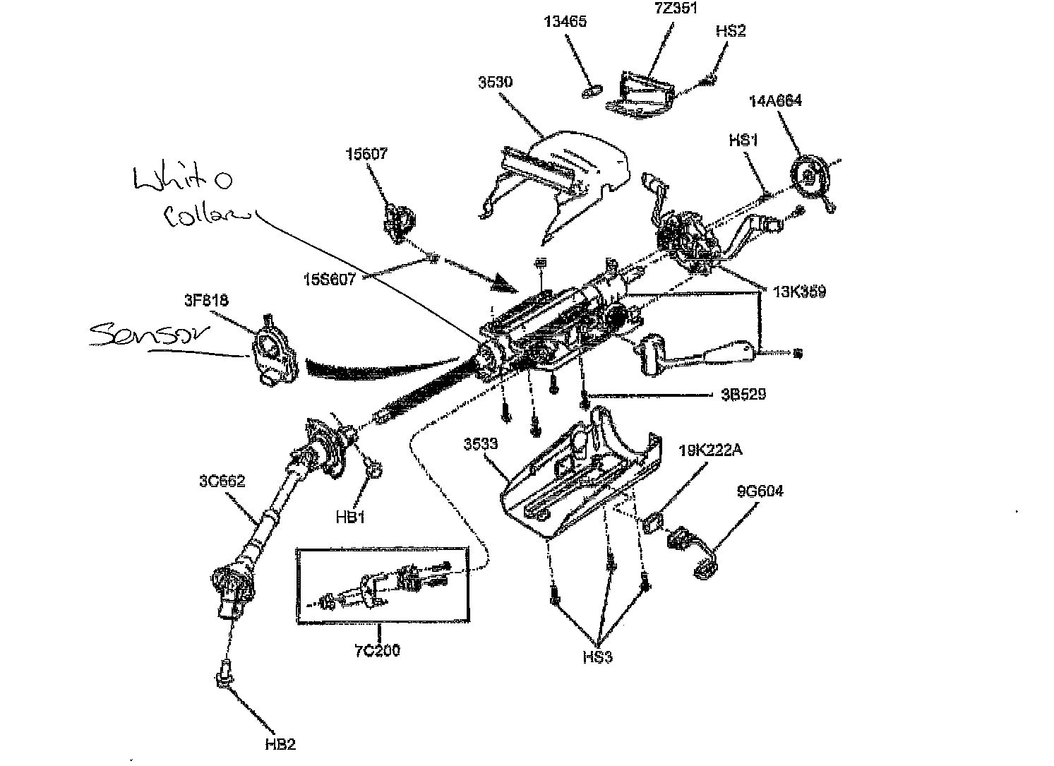

I have taken my car to my mechanic instead of ford this time. The problem appears to be a collar on the steering column for the steering angle sensor (SAS) is moving, a known problem in the first BF.
Whats annoying is why did Ford keep re-calibrating the sensor instead of swapping it out during the warranty period. The replacement part is $900.
