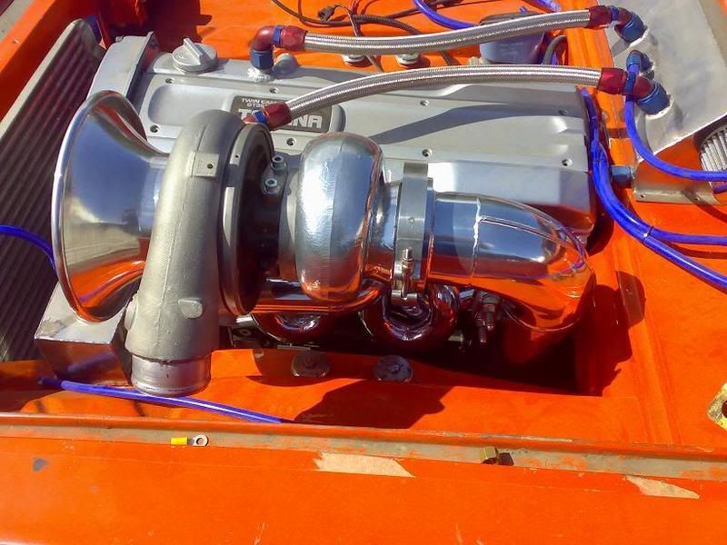

ETM Member 1,194 Member For: 18y 3m 2d Gender: Male Location: syd south Posted 11/02/08 10:05 AM Share Posted 11/02/08 10:05 AM its the same turbo I have on my toranagt4202r with 1.15 rear,as you can see its a big unit and not ideal for a street car.I also machined my rear housing back to accept a 4" vband Link to comment https://www.fordxr6turbo.com/forum/topic/42560-gt42r-approx-spool-rpm/#findComment-633029 Share on other sites More sharing options...
