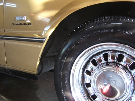

Post up a few pics of the XF mate, I have been thinking along the same lines for a project in the future....

  • Author
post-10881-1178609157_thumb.jpgpost-10881-1178609140_thumb.jpgpost-10881-1178609183_thumb.jpgpost-10881-1178609199_thumb.jpgpost-10881-1178609222_thumb.jpgpost-10881-1178609233_thumb.jpgpost-10881-1178609253_thumb.jpgpost-10881-1178609266_thumb.jpgpost-10881-1178609277_thumb.jpgpost-10881-1178609293_thumb.jpgpost-10881-1178609302_thumb.jpgpost-10881-1178609314_thumb.jpg
Here is some pics for ya

Nice job mate. I'm toying with the idea of getting rid of the top mount intercooler on mine and putting a front mount like you've done. Can you tell me what size and make your intercooler is and what flow/power it is rated to? Also, I can't see very clearly from the pics but does it have clean supply of air to it ??? ... it does look like it is shrouded a bit by the bumper.
